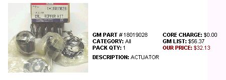

If the dampening springs are missing, get the whole recall kit from GMPartsDirect.com. Use the springs and save the rest till needed. The hardware kit that includes the springs is about $20.00 while the kit that has pistons, springs, seals etc. is just over $32.
