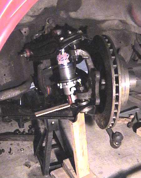

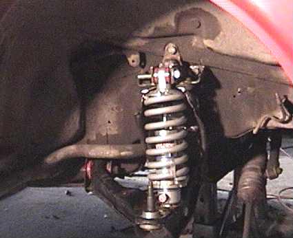

ok; some of the fiddling I am doing with the front:
I don't suspect things will vary too much from what you see here; the main issue will be adding solid reinforcement to the suspension members and frame to make sure that I 'put back more than I took away'........
which shouldn't be too hard. When you start to look critically at this stuff (thickness and quality of the steel used etc) it is an eye-popper that these little cars have held together so long!!
anyway; a shot showing a mockup of the coil over in place inside the former spring housing:
then the shock only (no spring) in place to check clearances to the outer members (ok); and to line up the bolt holes etc:
obviously I disconnected the steering to swing the rotor assy that far over;
by the way, that isn't the final brake assy I will be using before anyone starts chasing that; it will be .........
somewhat different from that.
I want to get the suspension all done first.
-g

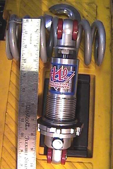

just to clarify
this is a SHORT and (will be necessarily) very stiff shock; very short travel. To go with something more comfortable would change this situation a lot........
here is the shock I am using:
yup
it's a shortie.........
but that is where I am going with this project. I am sure it won't be for everyone and I doubt I will put a lot of mileage on it myself.
just fyi etc

yeah; thanks; had a look. took me a minute to figure out what he is doing, but he has put a spring with adjustable sleeve in place of the stock spring, to allow easy adjustment of the spring height and preload. Nice idea and prob pretty easy to do.
I guess I will end up with the same effect but less range due to my short overall shock length. But that is ok with me (at least right now )

Did you mount the lower end of the shock in the a-arm or on-top of the a-arm? I can't tell from the pictures.
Are you using the colivers to also lower the car, and that is requiring the shorty shock use. I have drop spindles so I could do the same thing and use a shock that was 1.5 inches longer and get the same ride height, right?
Did you look at totally removing the old spring perch and rebuilding it so that you could use a longer shock and spring?

hi Martin;
a few different factors at play at once, I guess, in my choices;
This is a 308 rebody so I wanted it to go, stop and corner like it looks like it should. Lots of other upgrades slowly in the works, but the suspension is first on the list.
first I wanted to go for handling and cornering; and comfort was probably not on the list at all. Secondly, I already had two of these units from another project so I just matched them front to rear in an attempt to standardize but also....... why not? Anything the front hits, the rear will hit too, I would guess...... so either they will be enough or they won't. I don't intend to drive gravel roads....... and will get out and CARRY it over puddles...... LOL
I DID consider removing the spring mount but a mod is all I need to do; I will be reusing the upper 'brace' or bracket - with a bit of modding to strengthen it; it is actually quite convenient for me. I am mounting the bottom of the shock in the lower control arm; it also is fairly convenient. Not finalized yet but I have been focussed on the rear susp a lot lately.
I suspect that by the time I remove the old spring perch (already gone) and other materials - spring, old shock, etc - and then replace it with this new lighter unit that I may "brake" even (sorry ) weight-wise with the brake upgrades I am doing. We will see.
