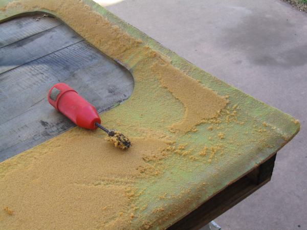

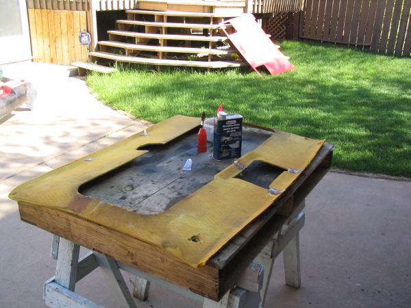

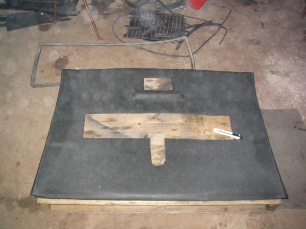

Man what a long day, but productive. I finished fiberglassing my new roof pannel where it was cracked. I also redid my new headliner with Dark Charcole headliner material.
Step 1- Clean area's that needFiberglass and resin. The apply resin to any unstable area's.
Step 2- Use wire brush to clean off all of the old headliner foam.

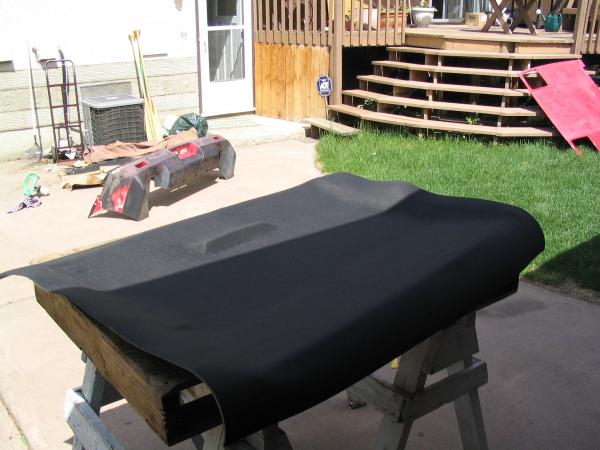

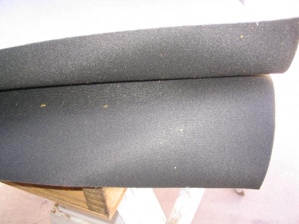

This picture kind of gives you an idea of the color but you really have to see it in person.

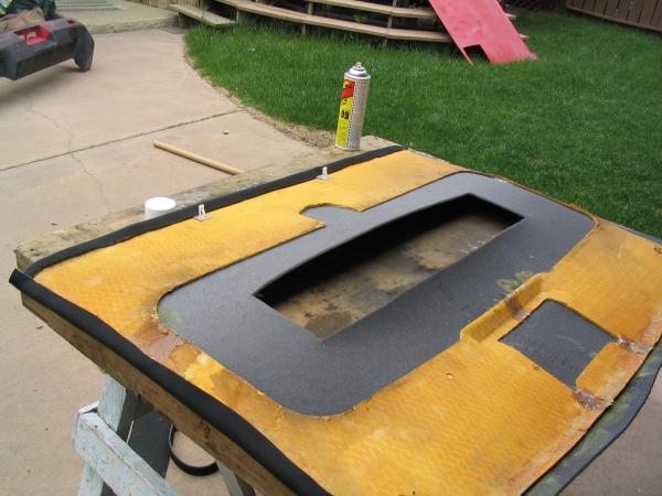

This is the adhesive I used. It was highly recommended at the place where I bought the material. It was 22$ but well worth it. The only problem I had was the nosil jammed up once and a while and it was a mad rush to get it uncloged.
Step 3- Put your yard over your headliner. Now I did half at a time but there are other ways that work just as well. So I folded half up and sparyed the liner, waited few minites for tack then slowly applyed down. Then simply folded up the other side and sprayed and lowered that side down.
Elenor84
Posts: 1946
From: Leduc
Report this Post06-01-2004 09:51 PM Click Here to See the Profile for Elenor84Click Here to visit Elenor84's HomePageSend a Private Message to Elenor84Direct Link to This Post
Elenor84
1946 posts
Member since Nov 2000
Step 4- Flip the headliner over and spray adhesive around the edges and fold the material up.
Then thats pritty much it. Just do all the edges then make a conservitive cut to allow for further trimming once installed.

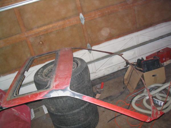

Next I worked on fiberglassing my roof as it got alittle cracked during removal.

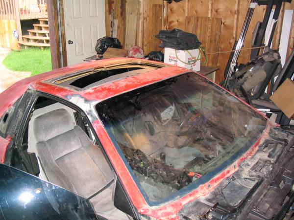

Then nothing left to do but install the roof with new butal tape and the headliner
And a shot of the headliner semi installed. I'm to tired tonight to put the stripping around and what not so I'll finish that tomorrow, along with reinstalling my new black interior.
