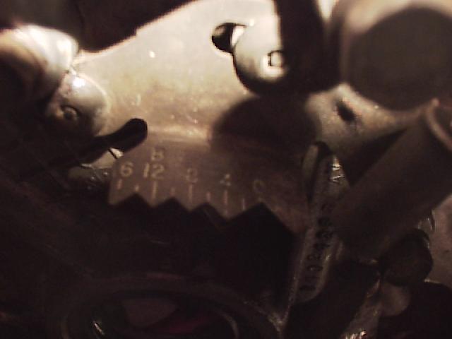

WOW you guys are quick. I'm fairly sure the timing is set right. I did ground the terminal, and I set the timing at 0 degrees (as per manual. but I'm not completely sure where the timing marks are though. Yes I did replace the 02 sensor when I first got it but it could be plugged by now from all the carbon And third I'm fairly sure the grounds are ok but not 100 percent.

Well the shop manual I have doesn't give me a reference as to where the timing mark is. I just happen to find one. It also says that on my year car it should be 0 degrees. Can anyone give me a reference as to where the timing mark is?

Yeah, the timing should be at 10*. If you look at the pointer down by the crank pully with a flashlight you can see the numbers on it, and that will tell you which notch is 10*. You might have to wipe the dirt off it first. If you have a scanner that shows you all your sensor readings check your Coolant Temp sensor. If it reads -40*F, check your connectors to it and it's circuit. A bad coolant temp sensor can make a car run rich and like crap also.

This is what the timing marks look like FYI.

One of my 86se was in the shop and the mechnic set the timing at 10 degrees because that was what the sticker showed under the deck lid. I drove it out of the shop and it kept stalling.
I took it back and he set the timing to 14 degrees and it runs great.

I have never heard of a fiero's timing being adjusted at "0*". I thought they are all 10*?????????????

Well as Quite a few of us know the best way to time a car is to road time it. But most people have lost the touch and the knowledge on how to do it.

I actually timed my GT by ear. Shortly after, I bought a timing light and checked it out. It turned out I had it set @ 12 degrees, which I left as is. Car works like a dream!

Blazin, how did you road time your car? did you do it with the connector grounded, or just advancing the timing while test driving?

If you think it runs good at 0*, set it to 10*, or even 12*-14* if you want to run Premium Fuel....
You'll be AMAZED at the difference. You MAY need to retard it for emission's testing if you have that in your state.... No matter what the sticker says, trust the good people on the forum. It should be at least 10* BTDC
