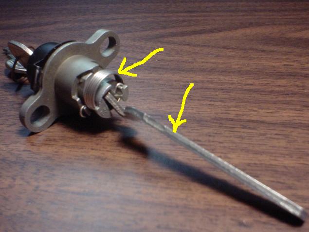

I got a trunk lock cylinder from the Fiero Store and treid to put in my deck lid today.
The lock had been punched out before I got the car and I do not seem to be able to get the rod to stay in the lock. I am obviously doing something wrong but I am baffled as to how this thing goes together. Does anybody have a picture or diagram of the assembly so I can see how the rod/rods fit into the lock cylinder and latch mechanism. I tried the search function for this and came up empty. Any help would be appreciated.

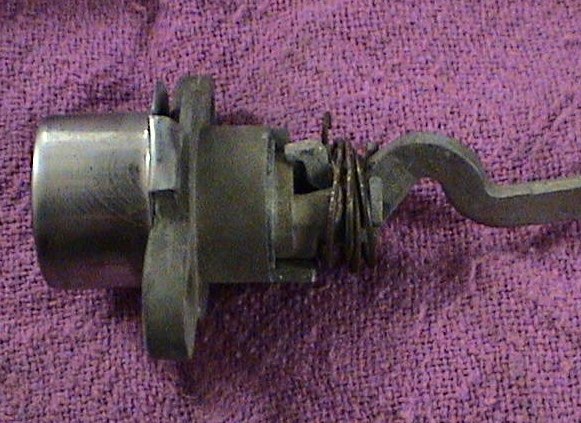

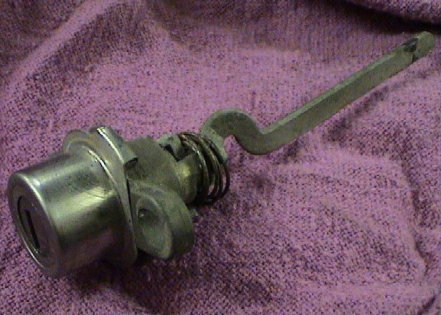

the twisty part of the bar goes through a spring,
(notice my spring is all messed up)
put the lock in first,
hold it in place and slide the bracket with the two flat blades in.
attach two screws.
install the latch,
sliding the bar into a slot on the latch.
dont totally tighten the two bolts that hold the latch in place. you may have to adjust it to line up with the hook and to have the deck lid closed at the correct height.
all done

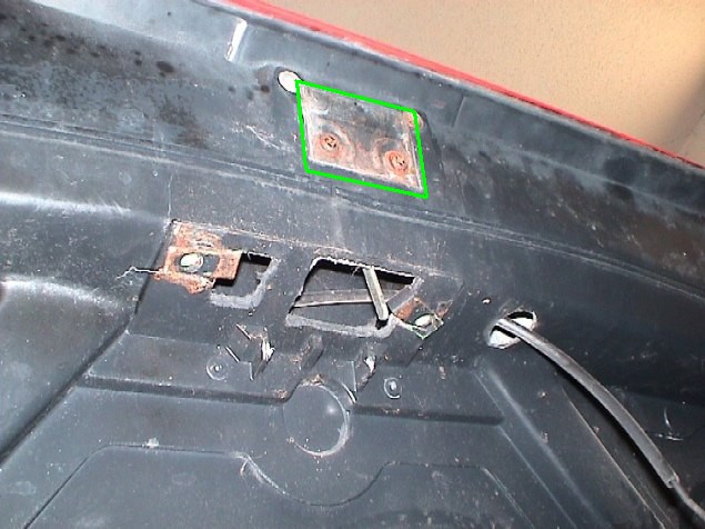

I have it installed but it there seems to be nothing holding the lock cylander in place. By putting the key into the lock I can push it deeper into the trunk.
By looking at the photos in this thread I am able to see that my deck has some previous damage or I am missing some parts. What do you think? The previous owner had issues with the lock when he closed a towel in the mechanism causing it to jam. This may be the result. If it is not missing any parts I can make one that would hold the lock in place.
[This message has been edited by RACE (edited 02-05-2004).]
buddycraigg
Posts: 13620
From: kansas city, mo
Total ratings: 478
Report this Post02-05-2004 01:07 PM Click Here to See the Profile for buddycraiggSend a Private Message to buddycraiggDirect Link to This Post
you are missing this plate.
what you can not see in this pic is that it has two flat blades, one goes on each side of the lock.
