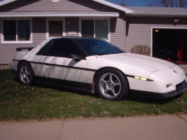

heres my daily driver, WS6 springs chopped 2 rungs,off, then pounded the cut part over to make a flat spot to sit in there nicley, its about a 2-1/4" drop and rides conciderably nice
also has KYB's and 225-50-16's now
pictured was the stock 205-60-15's and thats the front pass. side wheel
mine rides real nice i couldnt be happier

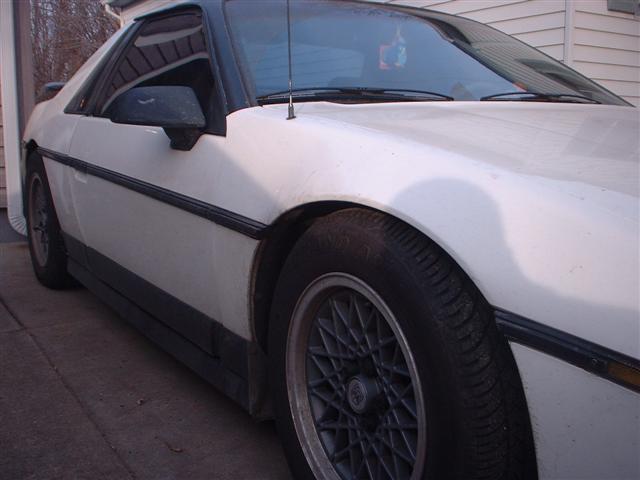

Report this Post04-05-2004 11:47 PM Click Here to See the Profile for $Rich$Send a Private Message to $Rich$Direct Link to This Post

Personally rich, i dont see how your car even has suspension travel, unless you modified the bumpstops, I cut 1.25 coils off my car, and found it dropped about 1.6 inches or so, and i found that my car had about 1/2-1" of travel before it hit the bumpstops.

honestly, my car rides nice, all concidering of corse, ya.. it's a little bouncy but its NOT obnoxioux and not bone Jaring
i used to have WCF 400lb/inch springs and these are like a caddy compared to them
