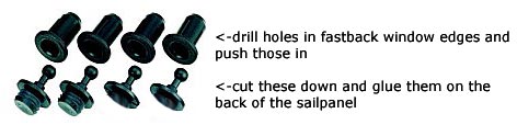

It would be great if there was a system simmilar like how speaker grills are attached to speaker housings...they sit very tight but you can pop them out with a screwdriver. It could be possible to glue/glass some to the sailpanel but I am not sure whether the paint on the back of the sailpanel will react to those chemicals....I would be nice if you just can pop them out for a cleaning job or a paintjob
anyway, I see there are different options...so I got something to think about
found an example of some speakerplugs:
got some gears turning now.....grrr

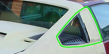

Anyway, I've been thinking about the speakerplugs thingie.It looks like the fastback rearclip has enough possibilties to put the plugs in:
Maybe I am carried away with this.....but it could be fun to try
Anyone sponsoring a new set of sailpanels when the experiment fails?
