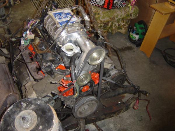

The block is a freshly rebuilt 2.8 bored 30 over. That is pretty much stock with the exception of a hot cam.
The Blower is a Used MagnaChager blower that was purchased off Ebay. It was orginally intended for a 2.8 S-10 pickup

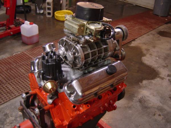

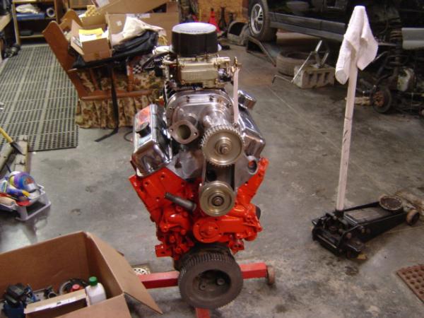

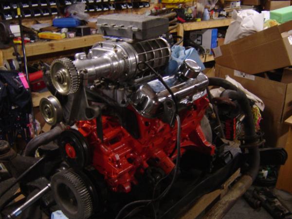

Im going to top the blower with a holly 390
surprisingly there is alot of room for the s/c pullys.

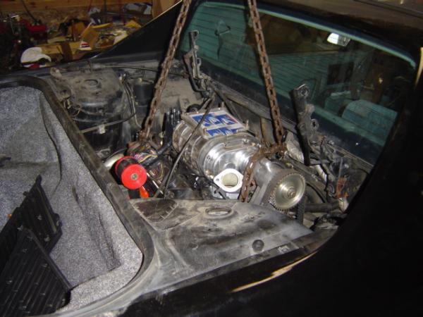

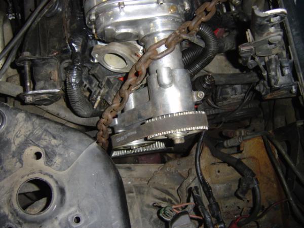

Ill post more pics as the work continues. I think I did pretty good today, I removed the cradel, pulled the motor, installed the new motor and got it back in the car in about 8 hours.

The blower will fit under the decklid, however the carb will not Im planning to find some sort of fiberglass scoop to cover the carb.
we picked up the blower for about $500. The beautiful thing on this project is that this is my little brothers car, so hes paying all the bills. however I did think he was going to do more of the work
there is about $2500 to $3000 in the engine right now, its amazing how fast the money goes. We were very careful to bargin hunt and lots of the parts came off ebay.

this blower will not work with the fiero lower intake. Its sits on a S-10 2.8 carbed intake. As far as cleaning the engine bay, yup that is today project I just want to trial fit the motor to make sure everything fit.
