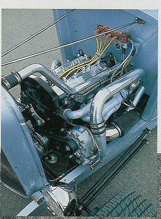

Here's another use someone found for one.
