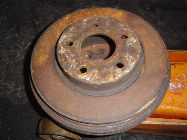

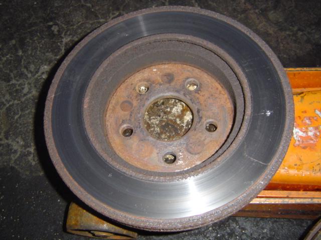

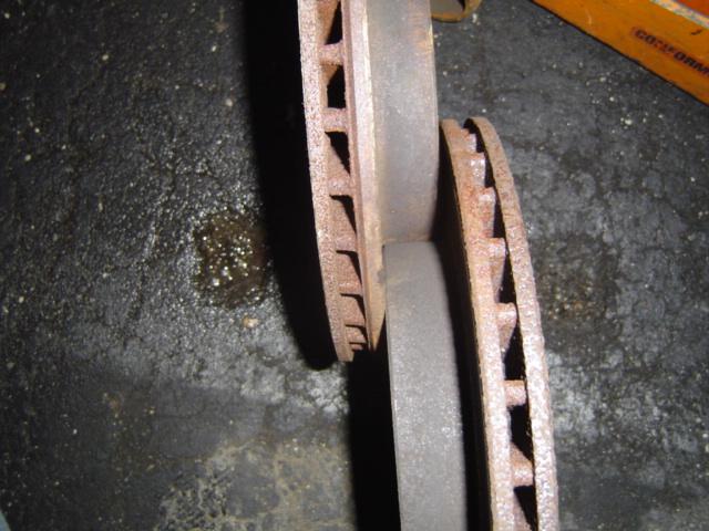

I figured out that Beretta/Grand Am brake rotors work on 88 brake systems. They are a direct replacment. They are smaller in overall diameter, however the 88's dont use the outer 3/8" of the rotor so the Beretta/Grand AM actually fit, They are only about 1/16" thicker and are about 1/16" closer to the wheel witch the caliper can compensate for easily. 20$ a rotor! What do you think?
Stock rotor:
Stock rotor with Beretta rotor sitting on top:

I'm assuming you're using the '87-'91 Beretta rotors, right? The '92-'96 rotors were about 3/4 inch larger diameter, and are a worthwhile upgrade to the earlier Berettas.

Measure and compare the inner and outer hat diameters. 88 owners have been using cavalier rotors for a while, but since the inner hat diameter is smaller on the cavalier rotor, they have had to machine their hubs smaller to get them to fit. Have you actually tried mounting this over an 88 hub? If it fits you have made a new discovery.

I have read about using those rotors on the rear of 88's but they will not fit on the front unless the front hub is machined down a little.

Is the centering hole on the beretta brake rotor the same diameter as the '88 Fiero rotor also?

The 88 front hub is, simply put, HUGE. No way the Beretta rotor will ever fit over it! At least unless you have the excess machined off.

The main thing I would worry about with this is making bloody sure nothing will bind up. Either at the start or as things wear in. For example, you wouldn't want the slides forced to the limit at any time. The slides need freedom to move not only for wear but thermal changes etc. Same for the piston. Remember the rotor and pads expand when they get hot. The brakes may seem ok cold but bind when hot if there isn't enough slack in the system. This would be very bad.
I'm not sure why, but all rotors seem to have a considerable "rim" around the outter edge that isn't used. There could be some sound reasons for that besides they just wanted more metal. Getting closer to the edge may not matter but I would avoid using a rotor right to the edge. This might could leave the pads hanging over the rotor under some conditions. Remember that the caliper and pads move when they are loaded. Just like an old record player with a bad needle... the pads want to track off the rotor durring braking. You won't be able to easily duplicate this loading in the shop.
