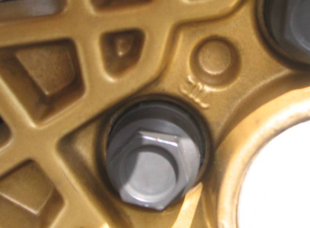

I see this symbol on every set of 15" GT rims that are on Fieros, 86 - 88 GT's. anyone know what it stands for or means? or possibly which way is up or down on it?
i am guessing that it is the logo for whomever made the wheels for Pontiac...anyone know?

its the fiero logo, pegasus(sp?) thats standard issue knowledge when you get a fiero.

oops DUH! guess a pic would help... sorry about that. senior moment

It might be a "W" logo, as in "Western" wheels?

Aren't they made by ROH? But I can't figure out how that logo spells anything resembling it.

"W" with steer horns. the corps logo

I've seen that on alot of Chrysler aluminum wheels too. I know American Racing made alot of Chrysler wheels in the mid 80's, early to mid 90's.
Anybody know who made the Fiero wheels?

I'm pretty sure it is Western. I remember a link to a website that stated this, but I can't find it now

I've seen that mentioned before as well. Western Wheel is a major contract manufacturer of automotive wheels, so this would make sense.

I have Western Wheels on my 88GT and the casting says 14x7.
I know they are 15's but its kind of funny to see a casting error like that.

Interesting..... I have a set on another car (not Fiero), made by ROH, and they have the same symbol. That's where the ROH suggestion came from in my earlier post.

Looks more like "JIL" to me but hey what do I know. I always though it was some sort of mark to signify it passed a standard for quality control and manufacturing, sort of like a UL seal on electric appliances. I remember some of my Volvo aluminum wheels had the same mark on them.

you might be right about that "standard for quality" thing. that makes sense, but i suppose it could be possible that it is still a company logo and that the same company made the volvo wheels as well. anyone have the answer?

I went to the wheel store and asked what it ment and no one knew. I looked around and everywheel had it. I looked at my Factory GM truck wheels. Same symbol. Looked at my wifes Eclipse same symbol. Looked at my fathers Pontoon Boat trailer Nope NOT THERE. So I conclude it may have something to do with being good for automobiles. And trailer wheels don't have to pass that test.

The symbol is JIL as at least one person noticed above.
One of the answers on Google.... (found using: "JIL" wheel rim )

Wheels
General Information
Info - Stock Wheels
WHEEL TYPE SIZE YEAR(S) STAMP
PART NUMBER COLOR OFFSET
N24 Turbo Fin 13 x 5.5 1984 Stamped JR
10031138 Dark Charcoal 42mm Offset
PX1 Turbo Fin 13 x 5.5 1985 Stamped JR
NX1 Standard Steel 13 x 5.5 1984-85 Stamped TZ
9590763 42mm Offset
PC6 Standard Steel 14 x 5.5 1986-87 Stamped TT
9590723 42mm Offset
N78 High Tech Alum 14 x 6 1984 Stamped HU
10034160 (w/Y82 Pace Car) White 35mm Offset
N78 High Tech Alum 14 x 6 1984-1988 Stamped JM
10030813 Charcoal 35mm Offset
N78 High Tech Alum 14 x 6 1986-1988
10046311 Gold 35mm Offset
N78 High Tech Alum 14 x 6 1988 Stamped XRM
10104452 Charcoal XUY
Compact Spare 15 x 4 1984-88 Stamped RK
9590503
PH0 Diamond Spoke Alum 15 x 6 1988 Front Stamped XRP
10104414 Black (19P) XUZ
(Made by Western Wheel) 37mm Offset
PH0 Diamond Spoke Alum 15 x 6 1988 Front Stamped XRR
10104416 Gold (60P) XXF
N90 Diamond Spoke Alum 15 x 7 1986-87 Stamped XBZ
10049057 Light Gray
10054562 Dark Gray
(Made by Western Wheel) Manufacturer stamp ATS
PHO Diamond Spoke Alum 15 x 7 1988 Stamped XBZ
10049057 Light Gray
PHO Diamond Spoke Alum 15 x 7 1988 Rear Stamped XRS
10104415 Black(19P) XXJ
10104417 Gold(60P)
Bolt pattern is five on 100mm circle for all years.
