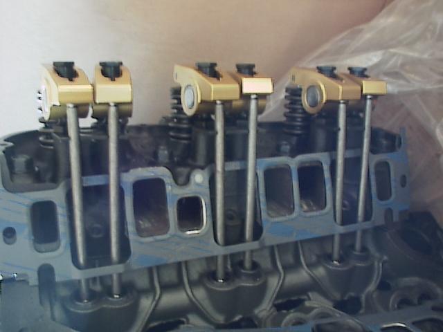

I have the CraneGold full roller rockers in a stock size with their 2030 cam. My old engine had the roller tip rockers. The new engine is also bored and stroke to 3.4 and definitely is more powerful.

Now that's a nice setup! I'd rather buy (and have bought) used Crane gold rockers than new inexpensive ones any day. (Not that yours are used.)
