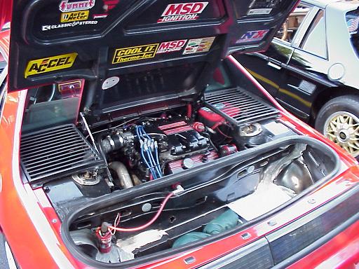

Yeah, I had one too. Fit perfect.
Here you can see it.
