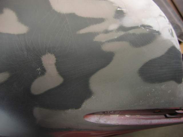

Yes, I understand what your getting at, and I do that for actual tears in the fascia (tear being defined as going all the way through). What I have is spider cracks on the surface of the urithane, that is what I am wondering about. They are all over the urithane itself and I believe don't even go below the initial urithane surface (the black outer surface). Perhaps I should take a picture of what I am talking about, as they say, a picture is worth a thousand words.
As promised... an example of what I am talking about. Hopefully the detail didn't get lost too much when I reduced it.

Sorry....I was watching Ghostbusters. If that's what I think it is, that cracking is still in the layers of primer that are still on the car. You're going to have to sand that out. You're probably going to get right down to the plastic by the time you are finished, and then you're going to need to use a primer/sealer and then a primer/surfacer before painting to reseal the plastic. That looks like it's been painted a couple of times in the past and you have quite a bit of paint left.

hehe, that isn't paint or primer your seeing, thats the black outer urathane that you see if you were to buy a brand new fascia. There is no paint, or primer in that picture (well, there is some of the original factory red paint around the bottom of the picture) The lighter splotches of color is whats under the outer black urathane coating because I had sanded through it. I have had to deal with spider cracks before, but have never ran into something like this, hence the reason I was asking if sealer/primer would keep the new paint from cracking.
