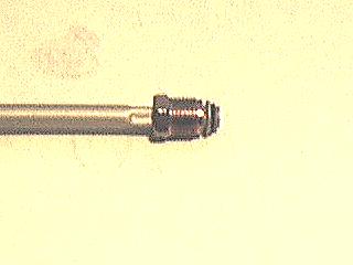

Why don't you use the stock type of fittings on the 6 cylinder ? Notice the O-Ring Seal on the end. They're used between the filter and fuel rail/tank.

This is a carb conversion.
Intake 2.8 fuel pump is feeding new line to a new on-the-fire-wall fuel filter, and then to a Mallory racing fuel regulator. The fittings to the regulator are all custom including the return. The Regulator has 5 threaded ports to either fit or plug.
I am not going to the expense of flared connectors. It is barbed connectors for the hoses.
I also am installing a Russell fuel pressure guage on line to the carb. There are a number of threaded joints to consider, and I am thinking better safe than sorry.

You have to stop thinking Fiero. Think Holley. The connectors used on the Fiero FI system are not used on Holley carbs or racing regulators. I agree with the liquid teflon idea as being better, but how you apply teflon tape is the issue. You do not put it on the end of the thread.
