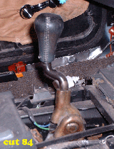

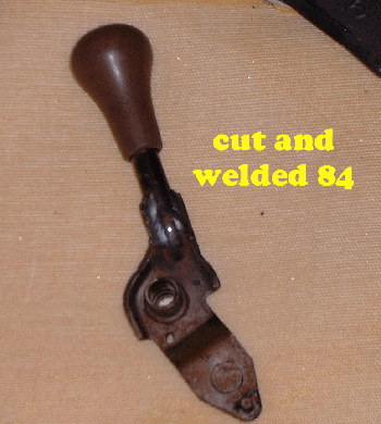

When doing a cut 84 shifter, here are two methods:
You can cut the top off your shifter and use a set screw to hold the knob. This keeps the kink in the shifter which brings it a bit closer to the driver.
Or you can grind the shift lever off the base, cut it at the bend and reweld it to the base. This gives a short, straight shifter which keeps the threaded top to secure the knob.
Some find that shift effort is increased, but I have both styles and would not use a stock length lever again. Besides, it's a freebie.
