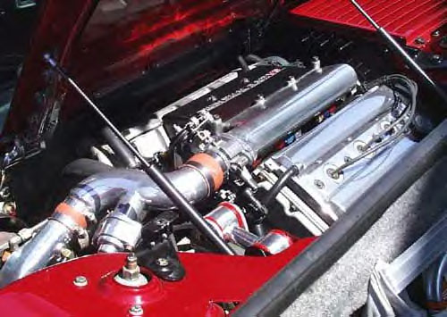

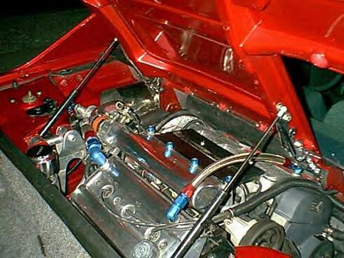

Well there is someone on the west coast doing what your talking about.. and there doing it to my GT... get in touch with Chris at West Coast Fieros for your questions.
chris' car
3.4 DOHC Turbo swap in progress
