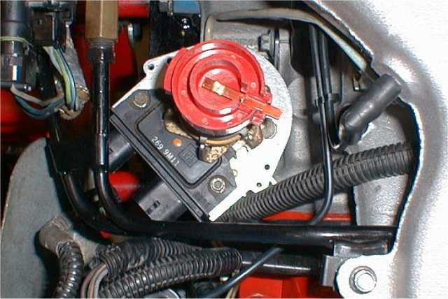

   Where is the Ignition Module on 88 2.8 V6 GT?

on the distributor. you can have it tested at Autozone if one is near you

Ok...I see it inthe picture here. I just didn't know where they
put it. Thanks

Take the distributor cap off and you will see it. two screws hold's it in. make sure those screws are clean, if not put in some new stainless screws.

I recognize that picture! There's more at http://web2.airmail.net/jsavage1/formula/
If you remove the module, clean the metal plate in the bottom of the module as well as the plate on the distributor where the module mounts, and apply a small amount of fresh heat-sink grease. Rat Shack sells it. Your module will thank you.

Replace the hex-head screws with phillips screws while you are at it. If the IM dies while on the road, you can then replace it with nothing but a phillips screwdriver (which you need anyway to remove the distributor cap).
