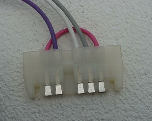

Not sure about the 84 but for all the others, if the switch connector looks like the one below, it will probably work. Try S-10 and Sonoma pick-ups, late 80's thru 94.

I had the switch in view of the handle. Can precisely such it is established on other models GM.

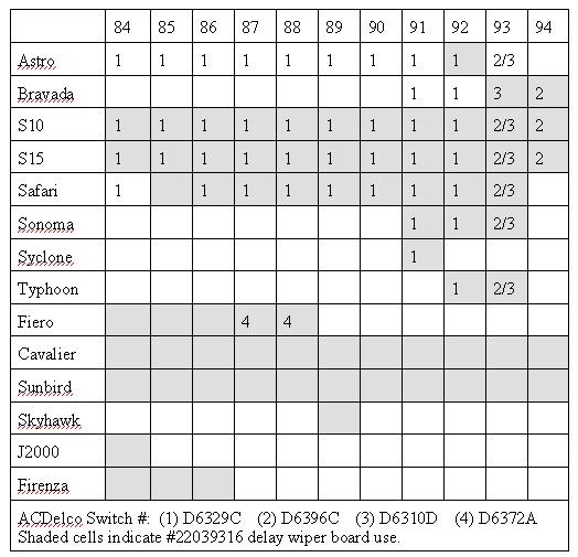

Here is a list of GM vehicles that use the same delay wiper board as the Fiero (shaded blocks). The numbers (1-4) indicate switches that while not identical, will work on the Fiero. There may also be others.

+ for spark1
nice homework.
