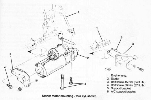

I've got an 84 and the long starter bolt keeps on breaking off inside the block. It isn't much trouble to drill it out but the broken ends are going into the bottom of my oil pan I think. I've got through about 4 or 5 in the last year. I put the car on ramps every few weeks to make sure the bolts are torqued down but it never fails. It always breaks. It isn't difficult to remove the broken bolt and replace it but it's bloody annoying and I'm worrying about the pieces of bolt in the bottom of my engine.
Has anyone else had this problem??? Any ideas??

and i dont know if it would help. but a lot of GMs come with a bracket to help hold the back of the starter in place. most get tossed the first time the starter gets changed but you might look in to it.

NEVER assume that because the old starter did or did not have shims that it is correct for the new starter. Every starter install, whether new rebuilt or used parts, has to be checked.
Very few people shim GM starters properly and I doubt many even know how. Even so called pros at many shops mess it up either because they don't know or don't care.
Repeatedly Breaking bolts is usually a small number of things. the wrong bolts, wrong bolt torque, wrong shim setup, or missing brackets. Or a combination of all thre above.
I don't know about older ones but my 87 L4 does have an extra bracket to support the far end of the starter. Even if a car never had one doesn't mean it isn't a good thing to add if you can. Starters are bloody heavy and need all the support they can get.

My starter has the bracket shown by spark above. It attaches to two studs on the starter and has a bolt or two into the block.
