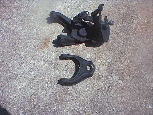

Today I returned to the u pull it and torched the bushings--easy enough, then used a punch to open the seam in the steel rolled sleeve and a little persuasion.
In no time I was headed to the cashier with my upper control arm. I degreased upper and lower control arms and spindle once home and painted them with rust inhibiting black paint.
I ordered new bolt and washer kit with bushings along with a new outer tie rod from The Fiero Store for about $65. I guess I will go ahead and buy shocks and struts for it.
Now the big question: Do I take all my parts back to Tire Kingdom and let them install and realign or do I attempt to put everthing on here and then return for the allignment???????

Well, today I recieved my new tie rod end, upper bushings (Moog) and bolt with end washers and spacers. As you can tell from the pic, I was lucky to have found an adjustable ball joint with the junkyard parts.

New Parts! Wonder if I have to take the upper control arm to a machine shop to get bushings pressed in and out or what????????
TK
Posts: 10013
Total ratings: 200
Report this Post09-16-2003 07:41 PM Click Here to See the Profile for TKSend a Private Message to TKDirect Link to This Post
The bolt isn't a press fit into the bushing. It just slips though.
Are people having a problem with the bolts rusting to the sleeve in the bushing? I've never seen that problem. It would be hard to get some leverage in there to break them loose that's for sure.

BFH. Yeah, I have to pry mine out. The bushings aren't in line so there is torsion on bushings unless the arms are dropped way down.

Yes, the inner sleeve on the bushings were rusted to the bolt (donor car at junkyard) I havn't gotten to mine yet---but what I usually do when parts look corroded is I begin spraying them with PB Blaster each day for several days before I do the job. Then they don't give me too much heck.

Tire Kingdom pressed out the old bushing sleeves and pressed in the new Moog bushings. $37.45 I also slung off my A/C belt this morning which was brand new.
