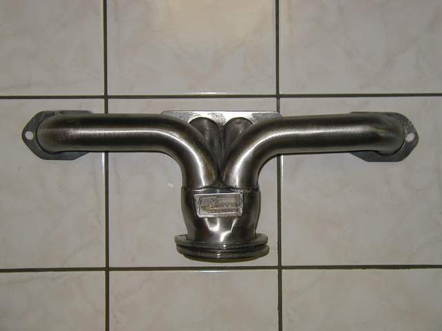

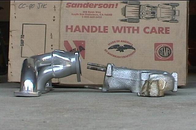

I think most guys are running the Sanderson CC90 block huggers. I modified mine for better flow. IMO they are crap. Poor construction, restrictive collector, overpriced. Quality like a $79 Heddman but cost $220. I am close to starting the exhaust on my 86 and will build my own with parts from headers by Ed. Ed has built headers for me before. Ed is the man.

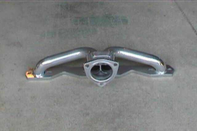

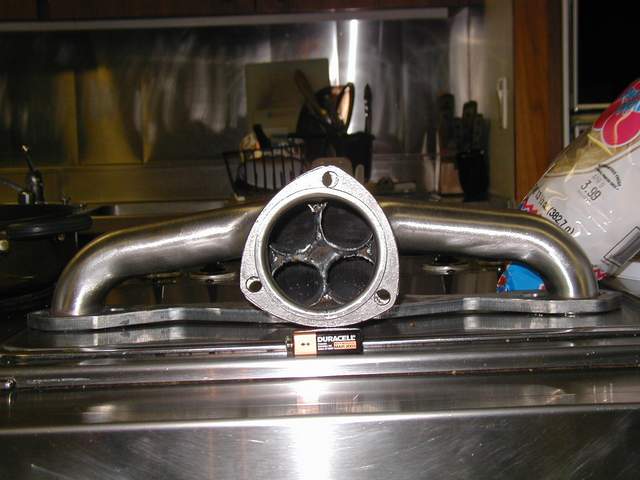

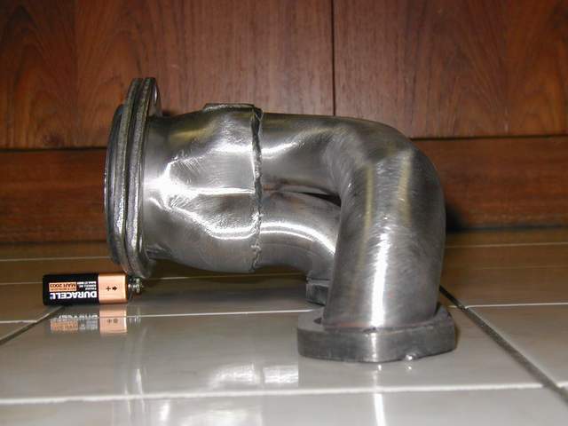

I want durability so i used cast iron RamsHorn style OEM.

I'm going with the ram horns too. Durable and cheap. You can pick them up on ebay for anywhere from $5 and up. The ones with the 2 1/2 inch colloctor is more expensive and came on the older Vettes. Thats what I have. I think most have a 2 inch collector.

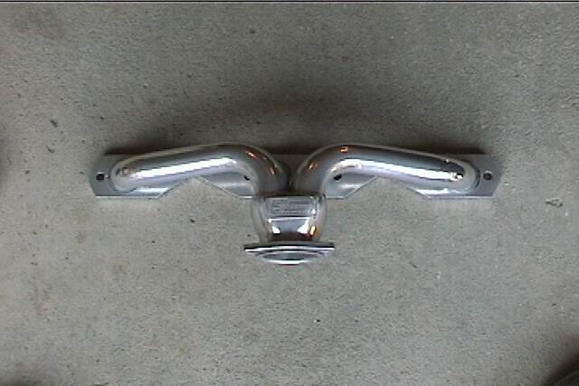

Originally posted by skitime:
I believe West Coast Fiero is now making headers for the V8 in Fieros.

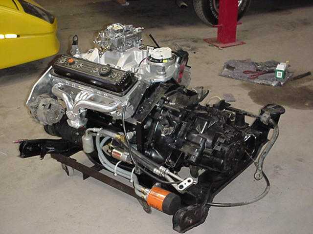

Heres a few shots of them installed on a block and trans, however no in car shots of them as of yet due to pending V-8 kit development.
( the above was the thoughts, views, and opinions of a disgruntled Fiero mechanic, and do not express or
imply those of West Coast Fiero, Fieros West, or any other organization - just that of this poor
bastard )
Can you imagine all the heat that would add to the engine compartment.
Also the tube from cylinder #1 would not clear the alternator. The 4 tubes from the front side of the engine run right above the starter & we all know how much starters like heat. Also, routing the remote oil filter hoses would be a nightmare. Can you imagine trying to service that exhaust in the car?
I'll bet there isn't a V-8 Fiero running around with that system on it.
Come on Eric, show us pictures of a finished car that actually has that system on it.

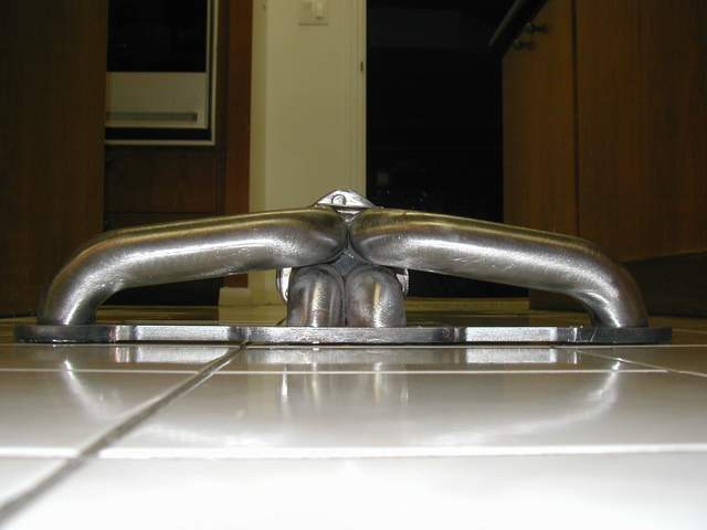

breakneck88: Block huggers hug the block too closely and the #1 exhaust tube interfers with the alternator. I've researched virtually every kind of header and the Sanderson is what fits best.

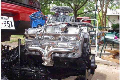

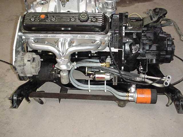

Report this Post04-22-2003 09:41 PM Click Here to See the Profile for cardealerSend a Private Message to cardealerDirect Link to This Post

CarDealer,
how are the SSAutochrome ones holding up? I've seen the other shorty's they sell and was far from impressed. They had thin tubing and thin flanges.

As my previous post clearly stated, these are not installed due to pending kit development as it is just not high priority at this point in time - read into each of my posts just a little more before you go on the defensive.
Question - any particular reason why these remote oil filter lines are so long and ( appear to ) run right by the header?
They have at least 4" of clearance to the Header and downpipe.
It's not about me being defensive, Lord knows you have nothing to offer that I need to be defensive about.
This is about you advocating (by posting pictures of) a system that is untried and untested. The guy asked about what people are using now, not some pipe dream of what you think will work.
Archie

Originally posted by KissMySSFiero:
CarDealer,
the ones i got are great, although i didnt get mine for as cheap as on ebay. i ordered mine directly from ssautochrome. i had a 2 minute phone conversation with the people at sanderson and swore i would never do business with them(her) again. the ones i got from ssautochrome seem well constructed, thick flanges, ect. but for as cheap as they are on ebay, hell just buy two pair.
good luck
I was wondering about those when I spotted them on ebay last week.
They certainly look good on the engine!
(cardealer's photo- I'm just borrowing it from his Yahoo album)
Do you have any further details about your exhaust system (what else do you have in there? cat(s)? muffler(s)?) I'm just curious, as it'll be a long time before I get around to actually working on my V8 project

Originally posted by breakneck88:
Hey Now!!!!
Everyone take a time out!!!!! lol! Wow!
West Coast Keep working at it! the experimenting is half the fun! I think I might try the ssautochrome headers. Although I am curious to see if anyone has tried two left bank (ODDS) headers, instead of the center dumps. I am just not sure if the rear headers aiming out torwards the right rear would work??? So looking at the sbc from the back of the car, the front header goes left and the rear header goes right? Either way, with any of the above set ups you guys are running, Do you run true duals???? and what mufflers are you going with? ( this is kind of changing the subject,) I appreciate EVERYONES experience, opinions and attempts.
If the front header goes toward the left it is going to be real close to the starter. If it goes to the right it will be close to the A/C compressor. The header also needs to stay a certain distance from the block. Also, for servicablity and clearance, the tubes of the header need to stay above the spark plugs. The center dump CC90 style header is the only one that fills all those needs.
On the rear header the header collector needs to be as short as posible to make the pipes fit and stay out away from the block to clear the axle shaft. A header that goes to the right will interfer with the toe link from the suspension & any pipe that attaches to it will be difficult to route. Once again I can't understand why people can't accept that someone has already tried all these variations.
Another note, almost all headers that are of the style you are looking at are designed for a front engined rear wheel drive car and they tend to stay in too close to the engine block for our purposes.
Archie

I use Archie's ramhorn manifolds. Dave Vizard's literature says that this is just about the best stock manifold you can get your hands on in terms of flow (i.e., cfm). There is no doubt in my mind that it is extremely durable, fits well and performs well.
