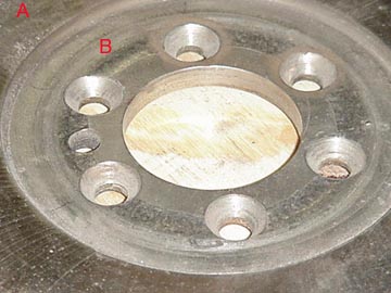

I normally stay out of v-8 threads, since I don't have one nor do I plan one @ my age , but Archie has touched on something that I know a little about, & his thread has slowed down a little while Archie is busy doing what he does best-building fine Automobiles-so I'll take this oppotunity to comment.
Using tapered holes & matching tapered socket head cap screws isn't an exact science. It CAN be, if done right but you better have the right equipment and QC controls in place to do it (not saying that the shop in question did not, since I don't know). My experience in medical grade machineing applications where close tolerances of say +.1000/-.0000 (+one ten thousanth, minus 0)give me a little insight into what Archie is talking about concerning using these bolts & angled holes. If you look at the picture, you can see some contact points down near the bottom of the holes. This is what usually happens with these bolts & counter sinks. Not only do you have the side thrust & subsequent bending Archie mentioned, but during the milling operation, it is difficult to match the angles of the holes and the angles of the bolt heads exactly, which is what you need to keep the flywheel perfectly centered over the center of the hole pattern. Improper feed rates, differences in material hardness, tool deflection all play a part in this. It is very easy & even common to get an egg shaped countersink too, even tho you can't see it with your eye, you can see it under a comparator. If the countersink is not perfectly aligned with the center of the bolt hole, you again have the off center stresses Archie is talking about. Another problem comes from the fact that all bolts aren't created equal-that is, the angles aren't perfect right out of the box, even with good grade bolts. We use machine bluing and match our bolts to the holes to insure uniform contact areas, even if we end up having to use a precision angle grinder to make them match, then use a spot grinder, similar to a valve seat grinder to polish the counter sink.
Now say you have a perfect match of bolt & countersink. Great, you know now that it isn't likely to back out, except the torqued down bolt now has more clamping force than a regular cap screw between the 2 surfaces. It means it will take a great deal of force to remove it. Anybody that has removed many allen headed bolts knows how easy it is to strip out or break tools or bolts. Add to this, the side thrust on the bolts, it is just not the best way to go on something that is subjected to the streses of heat & fatigue a flywheel is. I can't tell by the pictures, but it doesn't look like the bolts are matching the angle of the c-sinks, at least on some of them. I would also be concerned at the little imperfections you can visibly see at the tops of the countersinks.
Just my thoughts, now I'll leave this to you experts on V-8 swaps.

OK let us hear from the people that have used this flywheel and bolt combination and have had it fail.

Related to the Zumalt flywheel, which mine is modified, but still has countersunk bolts, I only have had one problem where one bolt had to be heated to be removed. It's not that I dismiss what Archie is saying, I'm sure there were some bad flywheels produced. One of the benefits of the Zumalt flywheel is that you have a lot less rotating mass because it's thinner. I wouldn't want to do the math, but it should also reduce the initial loads on the bolts on initial acceleration. The forces are only one direction (except for bolt torque) in either upshifts or down shifts. As far as the Bolts coming lose, you should be using a drop of loctite on each bolt anyway, I've never had one back out.
Maryjane has made some real good points about the care that has to be taken when the flywheel is machined (Archie also showed how sins can lead to failure).
Bottom line is that anyone who takes the time to do research, knows people who can do the work required that they can't do, has the time/money for the project, can do a sweet custom conversion. Anything can be improved upon, it just take knowledge, time, money, it just isn't a short route.
