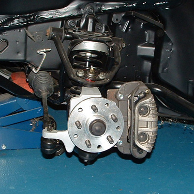

The front coilovers from Held Motorsports
do NOT mount in the same location as the
factory shocks...
In case the photo does not get attached,
I've placed a photo on:
http://specificmotors.com/images/heldfrontcoilover.jpg
For more info, refer to: http://heldmotorsports.com/sport.htm
I hope this helps.
dave

There are two basic styles... The RCC setup that Stuart has pictured, and the Held setup that Dave has pictured.
www.rccspecialty.com www.heldmotorsports.com
Having absolutely no experience with either, here's my take...
I like Held upper mounts because they bolt in place. The Held upper arms should be used with Held upper mounts because they were designed to go together.
I like the RCC lower arms because they are adjustable for caster and the Held lower arms are not.
Dave: You didn't have anything to do with the original design of your lowering knuckles, did you? I've been wondering for a long time about the use of Fiero rear bearings with a welded bolt in them. Surely GM has a suitable non-drive-axle 5x100 hub that could have been used instead?
