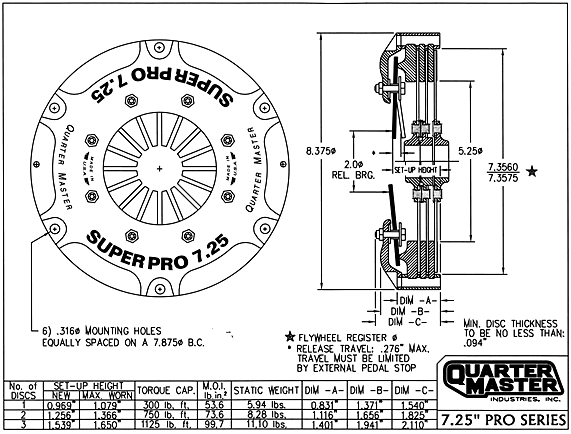

California Kid
Posts: 9541
Total ratings: 274
Report this Post11-14-2003 12:12 AM Click Here to See the Profile for California KidSend a Private Message to California KidDirect Link to This Post
This won't slip, but it's expensive, and you have to change disks every 12,000 miles.
aaronrus
Posts: 870
From: bradenton, FL USA
Registered: Nov 2003
Total ratings: 56
Report this Post11-16-2003 10:25 PM Click Here to See the Profile for aaronrusSend a Private Message to aaronrusDirect Link to This Post
3 discs heh? not a whole ot of slipping allowed heh?
