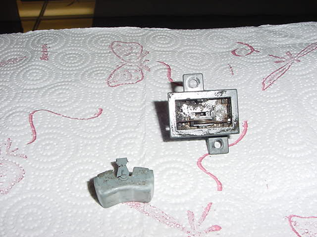

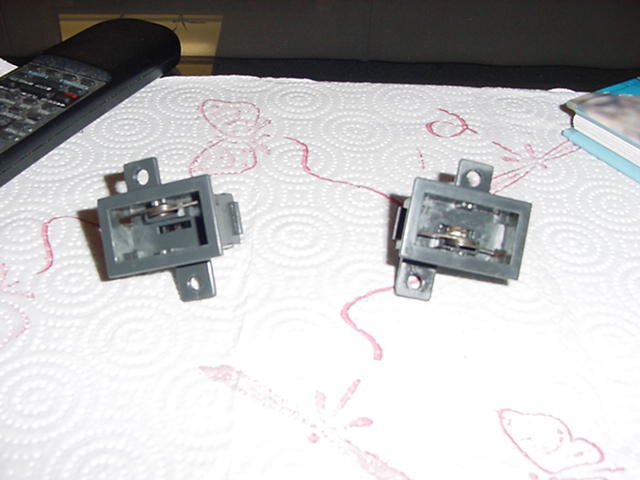

Just today, I took my switches out of the car (along with the rest of the dash) and decided to try to refurbish them. I replaced the switches in my 86SE, and also noticed the huge difference. I just got my GT, and the interior was not as clean as I wanted, I had planned on replacing the switches, but was amazed at how simple they are to take apart. Look at what I found inside of the switch
It may be hard to see but it looks like years of old armorall, and dust and cigarette ashes. I cleaned it out with contact cleaner, and repainted the gray portion of the switch with krylon.
I am waiting on the switch buttons to dry over night before I handle them, but they look like new... And will do the job until I spring for brand new ones.

Cleaning the top is nice appearance wise...
The motor's problem is the bottom half. If the tops look that bad then the bottom part isn't to well off.
Yes, cleaning the tracks is also important. You have to do both tracks and switches to most old cars... Many people only do one and wonder why it doesn't help much if at all.

I know, and that is the scary part. I used a small tube and sprayed the contact cleaner deep inside the body of the switch to blast out the crud. I got a lot out, but I will see how effective it was when I put it back in the car. This is a temp fix until I get new switches. There are other things more pressing that I want to spend the cash on right now.
