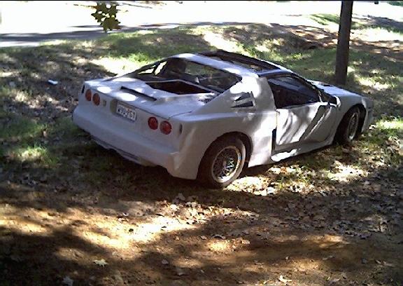

Mine started out as a Notchback!
SmoothGT!!
Custom Widebody GT!!
PostWhore of PFF!!
That still doesn't make things any better!

I know.. It's totally still UGLY!
