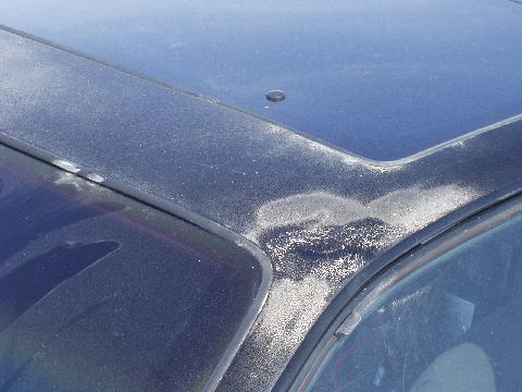

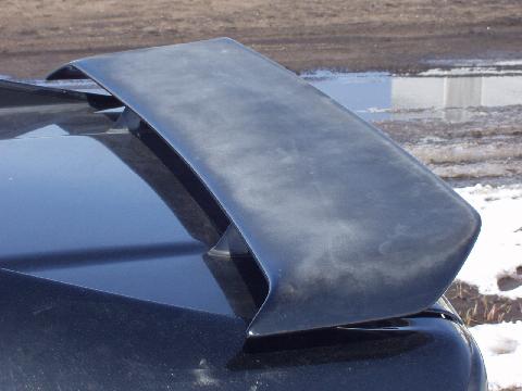

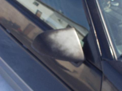

My car has bad sun damage in various places and I would like to try and patch it up until I can afford a paint job. Here are a few pictures of the damage.
Will spray paint work fine on my plastic car? If yes, any good brands or just regular rust paint? Will it look any better than it does now? Should I try and sand the orange peel off of the front part of the roof? Or does that need to be filled with mud? What is the front part of the roof made out of anyway? It looks like fiberglass. I also have a mustang scoop that I will be putting on the back deck, but it needs paint. Can I paint that with a spray can? and finaly can I wax over the parts I painted, or will the spray paint rub off? I have expierence painting models and motorbikes with spray bombs, and I can do a good job. But I just need to know if the paint will stick.

You could probably get the car looking better than it is now if you spray paint it. However, you'll likely find you'll get good results in small areas (like the roof and pillars), but you will not achieve desireable results on large flat areas such as the hood & decklid, and the doors.
Not sure what paint to recommend - as unsightly your paint is now, you would be better off saving your money and put it towards a "real" paint job.
But, if you do go ahead with spray paint, you'll need to prep the entire car - clean, sand, and clean again. You'll have to be careful with the sanding, though - you don't want to damage the panels.
As for what the car is made of - different types of plastics are used, no fibreglass (composites).

what you see is the clear coat delaminating from the base color. Some have removed their clear coat and then used a good wax to extend the time between paint jobs/

Forgot to mention - items like the spoiler and the mirrors can be easily removed from the vehicle, and painted. If you properly prep these, you should get decent results...

That could be my car when I bought it. Well, mines a black notchback, but same paint.
I have found that regular spray paint works great. The clear coat around the edges will need to be heavily feather sanded to avoid being able to be seen in the new paint.
I use scratch fill primer, shoot the base and then hit it with clear. After its dried, I go through the procedure for buffing and I can get a pretty good finish for $15 worth of materials.
Another technique is using a razor blade to remove the cooked clear coat and then using a polishing compound and wax on the remaining black paint. Not fantastic, but it gets the job done in a crunch.
On small areas of delamination, I've just shot on some black spray to make everything black again.
Please be aware, that the delamination is much like rust. It continues to grow. Eventually, you will need to get her painted.

I did mirrors, lower trim, spoiler, windshield wiper arms, door handles and front and back lower facias with Dupli-color GM black.
I thought that it came out very well for spray cans. It has been 4 or 5 years and it is just begining to chip a little bit.
I also did the rear deck grill vents, took them apart, did not last as long because of the heat.
I thought that it looked sharp with all the parts painted the same color black. Did not paint any of the body panels.

On my mirrors... I use Krylon. Satin or Semi Flat. I can't remember right now. It looks good but I used the wrong primer or didn't do something else right on one mirror. the Krylon didn't bond right. Several areas flaked off one mirror. (I was in a hurry on that one so it's not a huge surprise...) The other mirror looks like I painted it yesterday. (A couple year old now...)

Wow, I never knew there was so much prep work involved in using a spray can good thing I asked you guys before I did it. Canadian Tire sells spray paint for fixing rockchips on cars, Would that be a good choice? I hate tremclad too I tried to paint my motorbike with it and if I made any mistakes I could not sand them out.
Mustang Tail? It says mustang scoop and the reason I want to put a mustany scoop on the rear deck is extra cooling for when I install my turbo and it also looks cool
Red85GT-When did you get a MR2? Are you going to be around saturday? I'd like to take a look at it.
Thanks for all the great info, I would have realy screwed this up without it.

i have used cans for along time.. i even sprayed a whole door and i did a better job then most macoo paintjobs.
the key is 1. only use 75% of the can that last 25% will spit and make a horrible mess..
make sure it is warm out.
spend the 2 bucks and they sell this lil clip on to a spray can to make it like a gun.. your fingurs will get soar and tired using a can for a long time..
you have to try to blend it in to the rest of the car.. after your done wait 2 weeks for the paint to really stick and give it a good buffing to try to blend it in with the rest of teh car..
and a tip to jetman.. exhaust manifold black paint.. the paint that is supposed to be cooked on in a killen. just paint it and let your car run it will bake on enough where it wont fade and chip.

You should know that the clear coat is much harder than the color coat. That means sanding the clearcoat takes more time and effort but when you finally break through the clearcoat, the sandpaper will bite through the color coat much faster. Be careful.

a buddys car (red) was as bad if not worse than yours and he used the color matched Wax, and it really did work quite well, lasted real good for a week, but not much more, so once a week he'd just wax-on every time he washed,
bieng Black, it shouldnt be hard to match
its an easier alternative to rattle can

I agree with Rich on that one, I did the same thing with my red gt before i got it painted, wxing once a week is easier
