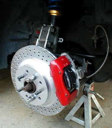

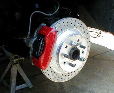

Rockcrawl has a nice setup for '88s.
www.fieroaddiction.com

Well the pics look nice, but does anyone have the prints for the mounting bracket...?
