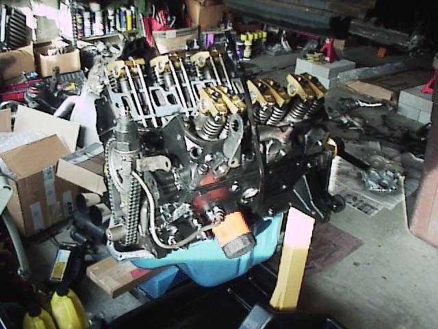

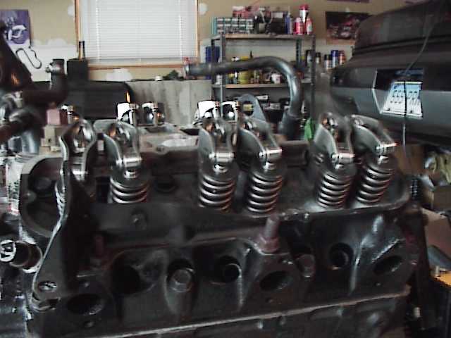

I had the roller tip rockers in my old engine, they are loud and make ticking sounds. Now I have full roller rockers, they don't seem as loud, but they still make noise. They both fit under the stock valve covers. Here's a picture of both. My new engine is an ARI 2.8-3.4 conversion. Welcome to the forum by the way.
