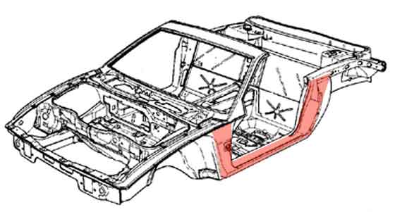

Hi!
I am plannig on to converting my 85 SE into a convertible any good links or past forums post about it or any one here had done it before.
Please mark where the frame reinforcements should go.

I'm almost finished building a 85GT convertible with an old (and discontinued)California Convertible kit. It's a pretty involved job. Before you cut the roof off, YOU MUST add a subframe which ties together the front frame members with the rear frame members. My frame starts at the front cross member and attaches there in a V pattern then moves back to the front frame rails, and runs under the car to connect to the rear frame members where the cradle mount attaches. You'll need to build this frame from 1" x 2" x 1/8" wall steel tubing. If you can pick up I have some of this material that I can sell you inexpensively. Otherwise try a local steel supply house.

A more factory look for the bracing takes a bit of work. I spoke to a automotive engineer on this matter at length and basically this was what I was told to do.
Reinforce the shaded area of the car with 3mm thick plate steel. Internally or externally, doesn't matter. For added strength you can also plate the trans tunnel. Look at a factory convertible. You wont find box tube running everywhere under the car.

Wow Talk about coincidence!
Thak you AusFiero.
Today I happend to talk to a guy that restores and builts antique cars and he mentioned to me the same you have said in your post. (I though he was just telling the tail), but 2 times in a day means is posible thanks.
He also ofered to help me get good priced plates and to help me cut them.
