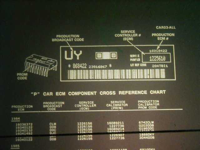

Here's the ECM info from the 22P.
Prod.ECM Broad ECM PROM PROM Code
1984
16036372 CLM 1226156 16089211 6742CLM
16040122 DDB 1226156 1227736 0203DDB
16040132 DDC 1226156 16089214 0196DDC
16041492 DJC 1226156 16089214 1438DJC
16041862 DKY 1226156 1226907 1888DKY
16040122 DDB 1226156 1227736 3044DDB
1985
16036292 DYU 1226156 16051108 6910DYU
16046342 DZA 1226864 16951389 6875DZA
16049042 FTX 1226869 16049348 9349FTX
16049052 FTY 1226869 16049354 9355FTY
16051052 HFL 1226864 16051108 1104HFL
16051232 HHZ 1226864 16051388 1384HHZ
1986
16047262 FAT 1226864 16085998 2968FAT
16047272 FAU 1226864 16052973 2975FAU
16047322 FBA 1227170 16051818 1819FBA
16047332 FBB 1227170 16060153 2902FBB
16055002 HWT 1227170 16055171 5172HWT
16055012 HWU 1227170 16060157 5176HWU
16055022 HWW 1227170 16060167 5180HWW
16055032 HWX 1227151 16060163 5184HWX
16060042 APN 1227151 16060153 154APN
16060032 APP 1227170 16060157 158APP
16060042 APR 1227170 16060163 164APR
16060052 APS 1227170 16060167 168APS
16062092 AAMJ 1226864 16062222 2225AAMJ
16064322 AATC 1227170 16064619 4620AATC
1987
16056462 BKB 1227748 16069537 3550BXB
16056472 BKB 1227748 16069543 3554HHM
16060022 APN 1227170 16060153 0154APN
16060032 APP 1227170 16060157 0158APP
16069552 ACMF 1227748 16122663 9538ACMF
16069562 ACMH 1227748 16122664 9544ACMH
16122682 ASCT 1227748 16143453 9309ASCT
1988
16069552 ACMF 1227748 16086769 9538ACMF
16069562 ACNH 1227748 16122664 9544ACNH
16083372 AKYM 1227170 16083436 3437AKYM
16033382 AKYN 1227170 16083440 3442AKYN
16083392 AKYP 1227170 16083446 3447AKYP
16083402 AKYR 1227170 16083450 3452AKYR
16086032 ALWM 1227748 16122663 6770ALWM
16122682 ANBP 1227748 16143453 2806ANBP
16122672 ANBN 1227748 16143459 2720ANBN
"NOTE: When replacing the Production ECM Controller with a Remanufacturred ECM Controller it is important to tranfer
the Production Broadcast Code and Production ECM number to the Remanufactiured ECM Controller Label. Please do not record on ECM Cover. This will enable positive dentification of ECM components throughout the service life of the vehicle.
Sorry, I can't get this to line up in columns as well as the Excel file."
And the PROM info locations.
