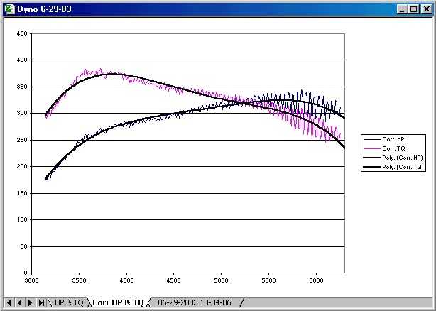

Well I finally got my 3.4l DOHC turbo car to the dyno today. After tuning with a wideband O2 sensor. I got 280 HP and 325 lb-ft at the wheels. With a 15% loss, that's ~330 HP and 382 lb-ft at the crank. Who said turbo cars don't make torque and are peaky? That torque peak is at 3600 RPM. Not until 5700 RPM does the engine torque drop below 300 lb-ft. Horsepower peak is at ~5800 RPM. I shut down at 6300 RPM and the engine was still making 300 HP. All this was with 9 psi of boost. Next time I head to the dyno (sometime before the 20th show), I will be packing more boost with the goal of 300+ HP at the wheels.
Matt
PS - Steve Hamm had his turbo car there as well. With the wick turned up to ~17 psi, he put down 340 HP at the wheels. That's 400 at the crank. He has a heavily massaged 2.8l engine with a T3/T4 hybrid.

Report this Post06-30-2003 12:10 AM Click Here to See the Profile for Matt HawkinsSend a Private Message to Matt HawkinsDirect Link to This Post
Have a look at the dyno sheet. Excuse the noise at the top end. That is what really out of balance tires do to the dyno. This is without any filtering.
Matt
You running a Getrag? Not to rain on your parade, but loss through that is more like 10% or less.

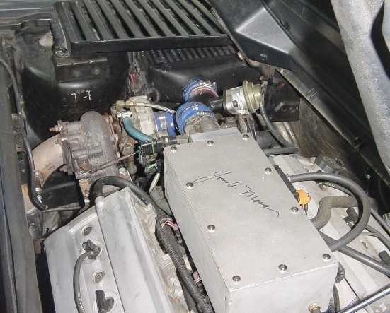

Report this Post06-30-2003 07:07 PM Click Here to See the Profile for Matt HawkinsSend a Private Message to Matt HawkinsDirect Link to This Post
Matt Hawkins
586 posts
Member since Oct 2000
As promised.
More on the way.
Matt

Report this Post06-30-2003 09:07 PM Click Here to See the Profile for WillSend a Private Message to WillDirect Link to This Post
Nice intake. Nice work.

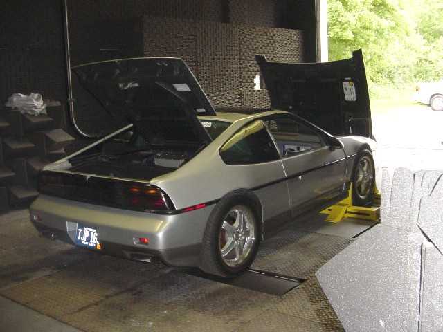

I will get some pics of Steve's 2.8l turbo car this weekend in Cleveland.
Matt

Nice Pics there Matt!! Though, did you change the plenum top? And who's sig do I see on top of it?

85frankenstein - I had to remove the carbon fiber top cover due to bulging under heat. The signature is from Jon Moss of GM. He signed it when I was on the HotRod Power Tour.

May not be fancy but it sure looks powerful!

I noted that in both sound files that they measured them in 4th gear. The 3.4L TED makes its best pulls in 3rd gear...
Why do it in 4th?

We use 4th because it is closest to 1:1 in the getrag. Also, it gives a longer duration pull for checking air/fuel ratio.
