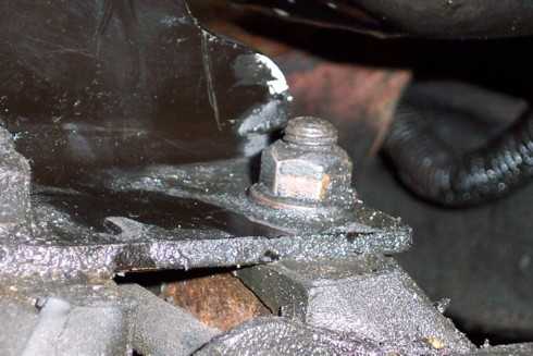

ditch , did mine recently (same as yours 86 Se V6). GTDude I suspect yours has already been notched or the pan somehow modded for it to come straight out.
Instead of raising the engine I decided to 'notch' the engine mount to make oil pan removal more simple in the future (it will most likely be me doing it again next time so I think its a valuable investment of time)!
Took one of these:
Marked off roughly where I wanted to notch:

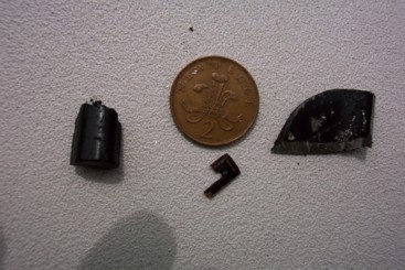

The jobs a carrot (2pence has exactly a 1" diameter, the other two 'bits' were floating in the pan!:
