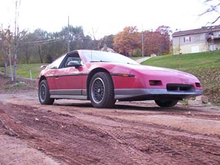

ive got some AR-25 american racing rims for my 85GT which are 14x6's two of the rims have good 215/60/14's on them for the front's, im wondering if a 235 or 245 will fit on the rims, and will they work on the car I KNOW a 225 will work, but im wondering if that extra 10-20MM will make a huge difference.
