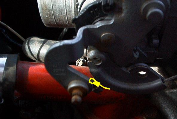

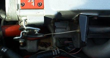

here are some pics from the mock up stage
In this picture you can see where I had to bend the throttle cable bracket ahead in order to let the throttle close fully when the cable was hooked up.
Somehow in this picture the end of the throttle cable has magically dissapeared, I have an arrow pointing to the next area of interest, and that is the U shaped tab on the bottom on the linkage
Using my totally awesome paint shop skills once again, I painted in what would be the loop on the end of the V6 throttle cable.
The collar on the cable, at the base of the loop is slipped over the U shaped tab where it is held in place.
I did have the cable fall off twice, so I simply bent that U shaped tab up, so that the cable could not fall out of position.
This has worked great for me.
