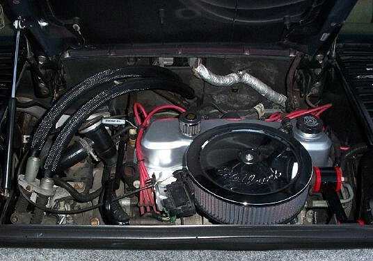

I just made a cover for an open filter element from a spare air cleaner housing. My question is simple, will the higher under-hood temperatures reduce performance by much? I like the sound of the unsilenced open filter, and airflow is probably increased, however will the less dense hot air rob any potential gain?
I will post pictures of my work after I get it painted and installed, meanwhile let me know if you have tried this and what impact it had on performance. I still have a complete stock intake system, this experiment was performed on spare parts so it can be easily reversed.

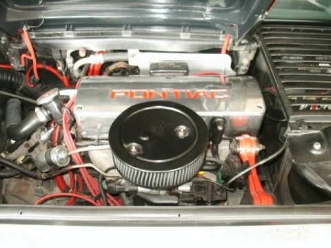

Report this Post05-20-2003 10:47 PM Click Here to See the Profile for T-top FieroSend a Private Message to T-top FieroDirect Link to This Post

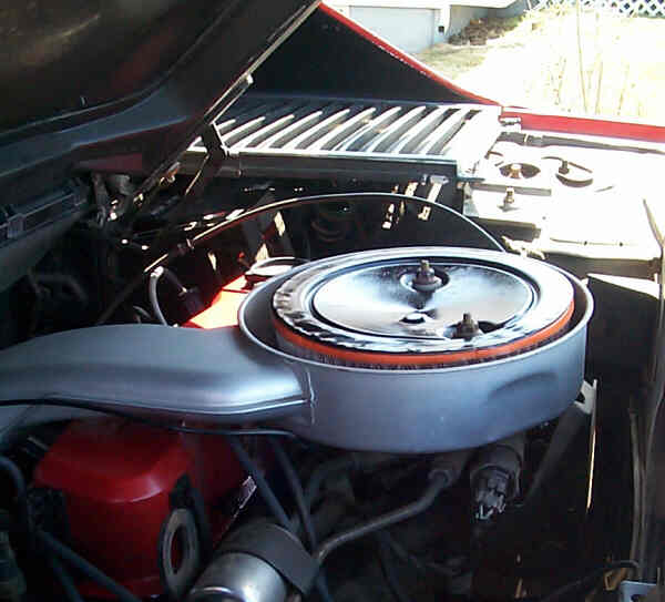

I made an open element air cleaner for my '84 2.5. I had to make one in order for my SD valve cover to fit. Even though people will tell you that it is bad for performance, I haven't noticed any adverse effects. My intake is not stock though. I have the Holley TBI and Holley intake manifold. See pic.

Thanks, My cover looks very similar, I may cut down the lower section as well, although I will probably just leave it since I will not have the interference problem. Cold air is definitely better but so is greater airflow.

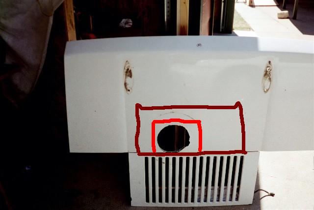

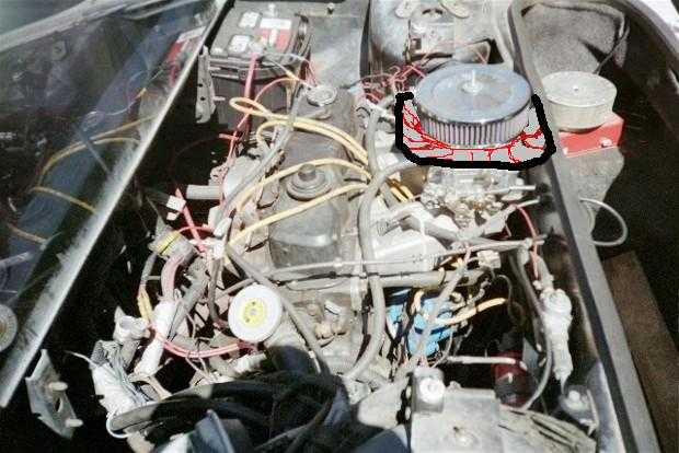

I've ran into this also. However, due to the extra height of my intake setup, I think I'll be able to draw air from outside.
Using this highly accurate and scientific drawing I spent 2 minutes on, you may be able to see what I'm talking about.
I believe by enlarging the hole in my decklid then surrounding the bottom of the air cleaner with a sheetmetal plate that rises to meet the bottom of the decklid, I should be able to draw large amounts of nice, cool air.
The dark red is a mustang scoop I'm going to cut in half.
Anyway, enough of my crazy plans. There shouldn't be any significant decrease at all with running an open element.

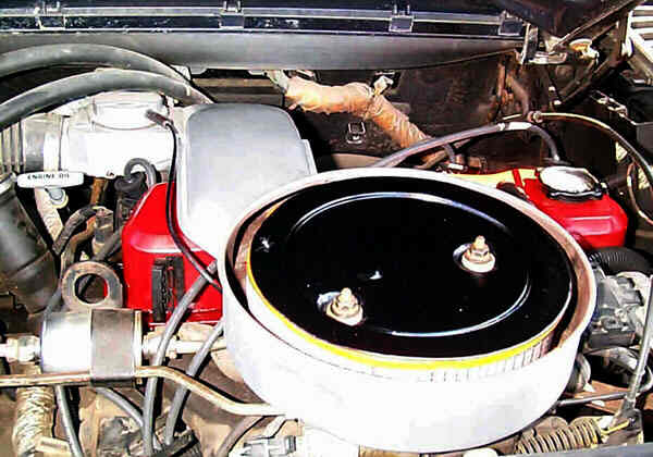

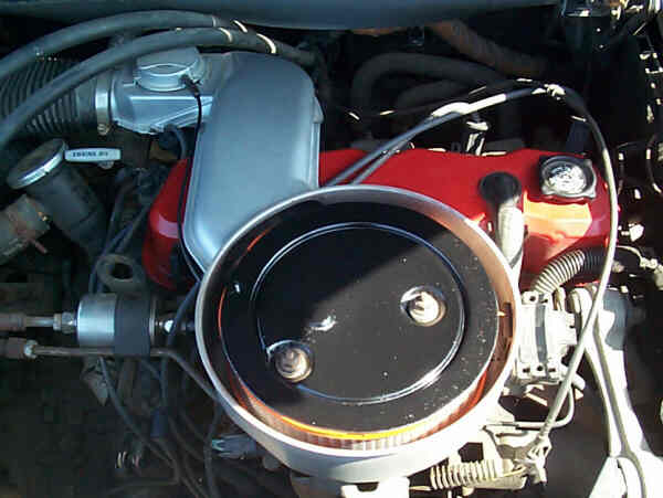

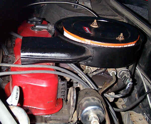

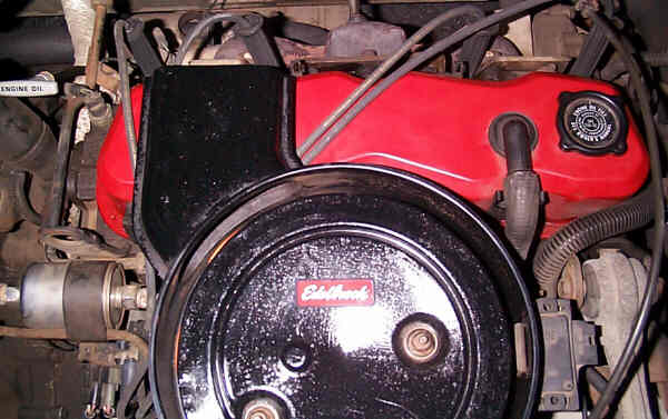

Cool FastIndyFiero (pun intended) I now have pictures of mine:
and
and finally (sorry about the poor lighting):
I do like the sound. I am still getting some cooler air from the stock snorkel which is still in place.
Ira

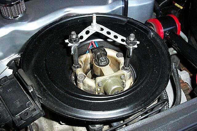

what are you guys doing about the MAP sensor?

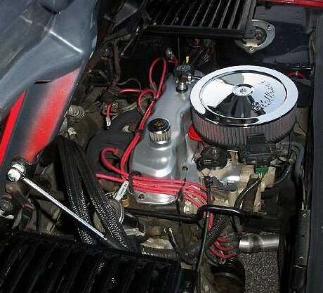

wuzzy, looks like T-top Fiero has his attached to the dogbone (or thereabouts). I still have my stock lower housing so it is not an issue (not yet at least). I am now working on a more minimalist version with the Thermac removed but will probably leave the rest of the housing as is.
The MAP sensor on a stock air cleaner is merely mounted there. I have mine just setting loose between the intake manifold and the dogbone. I originally intended to make a mount for it out of some sheet aluminum, but I see no need for it now.

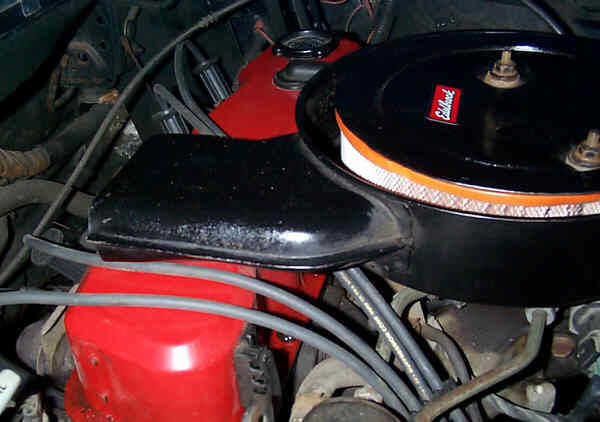

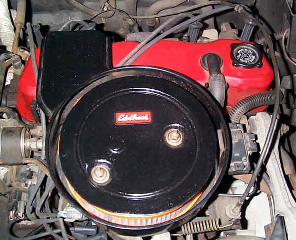

Here is my first redesign, I put away my original aluminum coloured intake with red cover so that I can return everything to normal. I plugged the thermac vacuum line at the TBI and I removed the cold intake hose and put it away with the rst of the intake.
I cut the new intake so that it still covered the crankcase breather and then freshened the original black paint. (used a dremel and hacksaw to cut the intake). Here are soem pictures:
Here is an overhead shot, sorry about the Edelbrock sticker, I couldn't resist.
Here is where I cut it:
and finally here is a side view to show where it now ends:
The aftermarket plug wires (Wells) were too short to follow the original routing so I now have them over the top (well clear of exhaust manifold heat).
Thanks to all those who offered help.
Ira
P.S. Added bonus, sparkplugs are now accessable without removing air cleaner. The holly scoop now just pumps air into the engine compartment (probably just as useful as it was when attached to the intake). The sound is great and it does seem to have better throttle response.

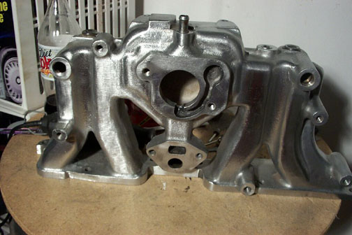

88 intake for sale, polished. $40.00
