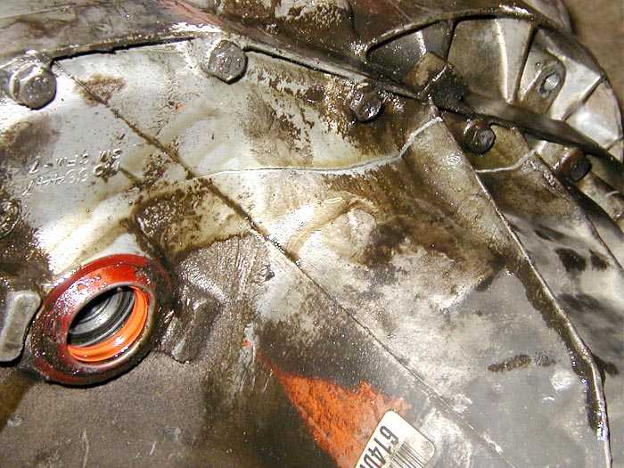

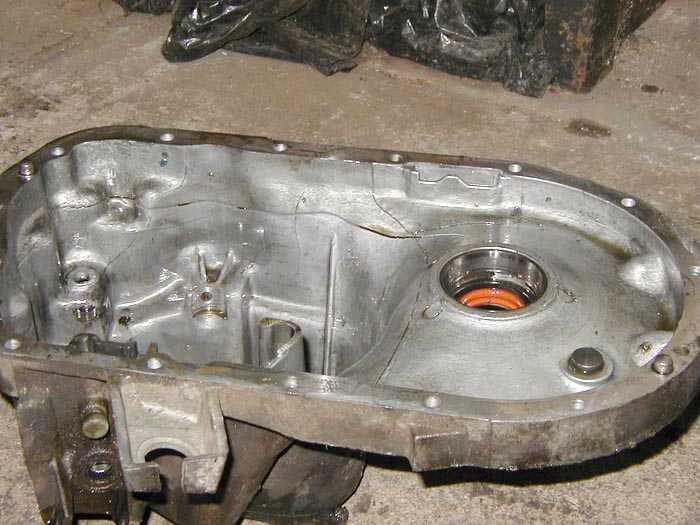

I liked my 4:10. It launched well. Pulled hard. As far as putting it in another car, Hmm... I'll let you see why I have my concerns..
Hmm, unsprung racing clutch disc + 245 sticky tires = broken tranny, or so it seems.

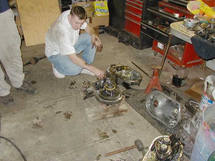

LOL, I dont know how this thread got brought back up, BUT I guess you missed the thread that was 1 week after this one. We installed the tranny on a Saturday afternoon. 6 Days later the following Friday I blew the tranny. It was something internal that went bad. So I ended up going drastic and moving to a 3.32 4spd. Then on top of it all, I got rid of the 225/50/15's that were really short and installed 245/50/16's that are HUGE. I do miss the power that I got from the low gears, but I really love the fact that I cna cruise at 120mph at a meageryl 3900-4100rpms.
I bet you could weld that right back up

Report this Post07-01-2003 03:43 PM Click Here to See the Profile for Capt FieroClick Here to visit Capt Fiero's HomePageSend a Private Message to Capt FieroDirect Link to This Post
Damn that is cracked in the same place as my first tranny.
