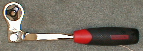

I took a trip out to the local hardware etc. store this afternoon looking for one of the obstruction wrenches as suggested by 87convert, and found one of these instead:
What may not be apparent from the photograph, is that the ratchet head can swivel 180° counter-clockwise from its current position, and locks in position at 45° increments.
It was on sale too! My a/c belt? Blissfully silent now.
Thanks all!
