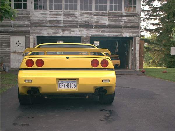

Here are mine. They are licence plate lights from NAPA store. 2 piece kit. the light plugs into a base and the base fits perfect when you cut the red reflector out.
