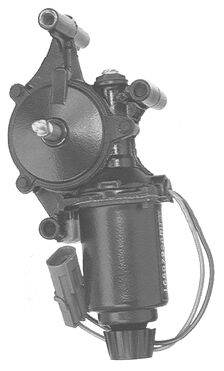

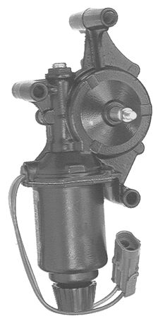

New motors are still available at gmpartsdirect for $94.82 each or at the Fiero Store for $136.50 each. The GM/ACDelco part numbers are 16507925 (left) and 16507926 (right).
