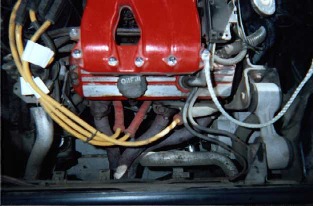

I just bought on eBay a header for my 4 banger <IMG src="http://ebay1.ipixmedia.com/abc/M28/_EBAY_b106499ec439099b153020b57b96b31a/i-1.JPG"> it is a hooker header. I plan on installing it with a spintek muffler, anybody venture the gain or los factor on that set up? Any concern with powder coating (non-ceramic) before install?
84 4-banger NB
[This message has been edited by revmikehill (edited 09-03-2003).]

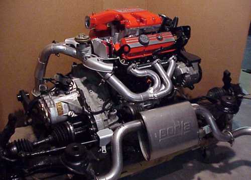

These are my FOCOA headers & Borla
fierosound
Posts: 15251
From: Calgary, Canada
Total ratings: 287
Report this Post09-05-2003 01:12 AM Click Here to See the Profile for fierosoundClick Here to visit fierosound's HomePageSend a Private Message to fierosoundDirect Link to This Post
Your engine LOOKS an awful lot like mine with those headers & Borla More pics at LINK in signature...

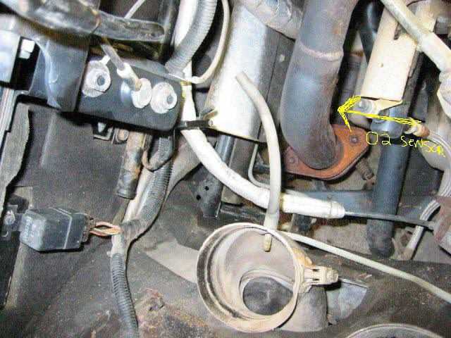

Can anyone tell me where to locate the 02 sensor?
I think mine is not working, but I can't find it.
Arn Brown
It is located near the bottom of the "Y" pipe about 4" below where the to sides meet. (It's closer to the bottom of the car than the top) It is pointing towards the passenger side of the car. (Assuming this is a V-6 were talking about.)
LordBoOsT
Posts: 378
From: Montreal
Report this Post09-05-2003 10:34 AM Click Here to See the Profile for LordBoOsTSend a Private Message to LordBoOsTDirect Link to This Post
Its on the other side of this pipe where this arrow is pointing.

Thanks for the help. I get in there tonight
Doesn't all born babies look alike?

I had my manifolds rewelded, ported and shaved. Together with open exhaust (deleted muffler) and open-air filter it might not gain much HP but it's response is much better and more fun to drive... + plus the sound I have now should be illegal!
Paul Taylor: I think with your exhaust setup your neighbours will hate you! Call me when houses are for sale

Alex4mula that engine looks awesome!!!!
Actually, that's MY pic that I took of MY engine. The headers and exhaust really do their job now that I've installed a Vortech Supercharger. See LINK in sig.
3.4L S/C 87 GT www.fierosound.com

Thanks B1Man. Yeah is his picture but my engine looked exatly like that before going in (got me a trophy at Daytona that year ). Of course Fierosound cars deserves good compliments. It is a very nice Fiero. Here are some of my pics;

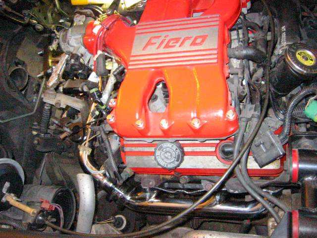

Alex4mula
7410 posts
Member since Dec 1999
Some more;
