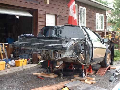

Originally posted by bloodfiero:
speaking of body panel removal if nebody has a video of how to take the body panels off an 85 i could rely use that.
Want to see how they come apart??? Come on out to my place (Almonte), the doors and roof are still there

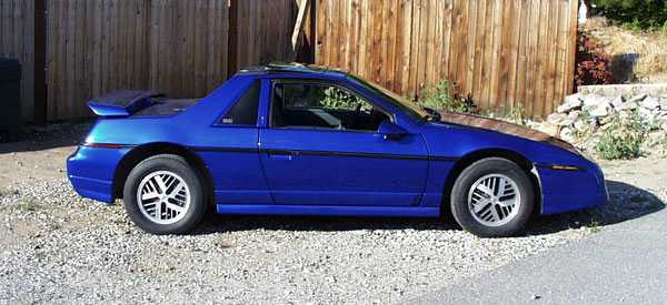

Report this Post08-29-2003 10:51 AM Click Here to See the Profile for jeremymarshSend a Private Message to jeremymarshDirect Link to This Post
I just had mine painted about two months ago, all I took off was the wing, all center molding and ground effect moldings that could come off and sunroof seal since I needed a new one anyways and sail panels since I wanted the frames the same color. The paint guy said it is a good idea to take off front and rear bumpers to but because mine was in a little accident it was so hard toget the front end to match up we decided to leave them on. I thank it turned out really good and had lots of compliments around town.
