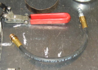

Tools needed if you decide to go ahead and replace the seals are pretty simple, if you have access to an air compressor the one scarecrow mentioned is what I used,(see pic below)

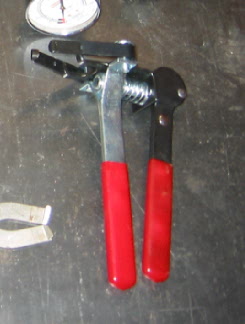

you will also need a valve spring compressor, (see pic below)
these are fairly cheap and easy to use tools.
The trick is to keep the valve from dropping into the cylinder after you pull the retainer and spring, the air tool presurizes the cylinder which holds the valve at the top.
