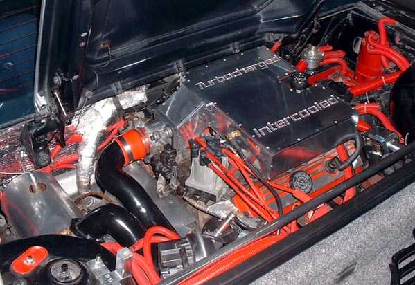

I haven't done any performance testing yet, but it should flow a ton more air than the stock plenum. I'll post #'s when I have a chance to test it.

How much boost did you lose after putting that on? That should give an idea of performance increase/decrease. Or a before and after of intake temps from one plenum to the other would have told a good story too

I've been thinking about something similar, but for a N/A 3.4, with a bit larger TB. Is that a stock TB? Would you care to share construction techniques?

I havent had a chance to even start the car yet, let alone drive it. I've been busy with other things. I don't plan on loosing any boost just by bolting on the intake, Lag my be a bit bigger due to the increased volume. My turbo will have no problem making more boost if I need it. Off idle power should be increased due to the increased volume, most important is that it looks better than the stock plenum!!

Any chance to get a detailed write up on how you made that including I/D volume as well as any photos of the Plenum off the car?
Looks like you just made a new upper portion of the plenium, am I right? If so what other modifications did you do to the middle and lower, just old fashioned porting?

Did you modify the middle and lower intakes? That plenum can't flow more than the weakest link downstream. But it should help hi rpms a lot, since you've effectively shortened the runner length. Looks really good.
If you've ported out the lower manifolds, it should really scream!

It seems that you'll have a noticeable increase in lag with that new airbox. I'm curious to see how it effects power though, I'd love to see a before and after dyno run!

I would be curious to see the inside of it or a design drawing.
Slumpy, did you actually dyno 235hp or is that an estimate?

The name is Sluppy not slumpy!! And yes on 8lbs boost before the intercooler and the 2.5" mandrel bent exhaust, I used a G-tech Pro and got 235hp at the rear wheels. I've gotten as high as 245 with the intercooler.
The inside is open with bell-mouthed opening leading into the ported intermediate intake.
I did start the car and drive it, no noticeable increase in lag. Off idle power felt way better, pulled harder in the upper rpm's. Numbers will tell the story.
