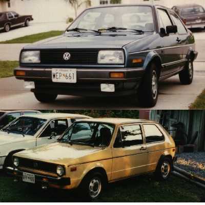

I used to own an 85 Jetta & Rabbit diesel.
They were great on fuel mileage, 45 - 50 MPG !
I know, people will say, "oh it would be so slow" - So what, I'm not looking for a weekend racer. Just thinking about a highway cruiser.
It'd be nice to go 500 mile to one tank !
There really not to noisy. The one's I had would just purr at idle. They didn't smoke like to old diesel's used to.
What do you all think ?

Hey, sorry it took so long to add more to this post, I was at work all day.
The 85 jetta motor was just fine, I bought it with 62k miles, put another 235k miles on it, and sold the car for more than I bought it !
Got the rabbit used, it also made it to 250k miles. Both were 5 speeds. - In fact the rabbit came w/out A/C, I had a guy install one from another rabbit, 200 bucks later, it would freeze your butt on high !
I guess I had good luck with both. The size is about the same as the stock 4 cyl.
The only engine repairs I ever made were replacing the timing belts (normal 100k repair) and replaced the injectors once.
Heads were never off.
From the ones I had, the engines should do well. The weight of the cars are about the same.
Nothing high tech, no computers needed for those.
This was an idea, if I could find a wrecked jetta/Rabbit w/good engine, might make a interesting project.
From some of the posts, sounds like some people had engines that gave them trouble.
Out of my two and the four my friends had, all were trouble free.

Yes, I posted something that awhile back. Before replacing the injectors & fuel pump, mine would dump out thick black smoke when nailed.
Afterwards, it ran clean, you couldn't tell it was a diesel.
