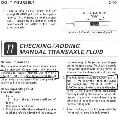

While I hate to argue with you and I do fully agree that syncromesh is better. GM did reccomend engine oil in at least the 85 manual tranny's. I would not make this claim without evidence, so here it is. This is page 2-10 of the do it yourself manual. I think that this is where a lot of people get the idea that engine oil is what to use.

GM had a service bulletin out which said to switch to GM Syncromesh trans fluid to correct hard shifting when cold. Several other auto makers, such as Honda, use GM Syncromesh to cure gear grinding. It's great stuff, use it in my car! Spend the extra $ and get something good!
YUCK..... That explains a few things..... Thanks.
At any rate... I wouldn't recomend using engine oil in the transmission when there is something much better that is made just for this job.
GM released at least two TSBs for the FWD/Fiero 5 speed transmissions. One each for Muncie and Isuzu. Both say use the Synchromesh. (The TSB numbers are in my cave.) These TSBs supercede both the owners manual and the shop books.
The Engine oil won't hurt seals. It is probably ok for the bearings and gears. Where it runs into trouble is with the synchronizers. Engine oil can be so slick (or stiff depending on temp and formula) that the synchro's can't do their job right. ATF can cause the same problems. Besides making it hard to shift, synchro problems can damage, even ruin, the tranny.
It's funny in a way.... People gripe about the price of the Synchromesh fluid but think nothing of paying $4-5 or more a quart for Mobil 1 for the engine... You change engine oil way more often than transmission oil. The service interval on the transmission is what? 25,000? 30,000? The majority of people that actually change it only do it every couple years at best. Most owners don't change it in the entire life of the car.
Some car makers do call for other oils... Use what they tell you.
With 80+ weight oils... make sure you watch out for the API service class!!!!! GL-5 oil must not be installed in transmissions that use GL-4. (Most of the cars I've seen use GL-4 but not all.) While the API Weight is often the same for the two oils the formula is not and using the wrong one can ruin the transmission.
