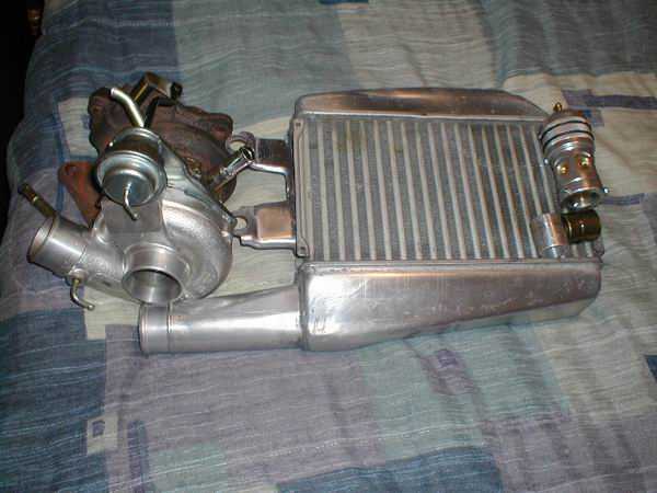

Jncomutt
8915 posts
Member since Apr 2001
Some parts collecting dust (the BTM is gone, using a chip). Soon as I get home though, on they go!!

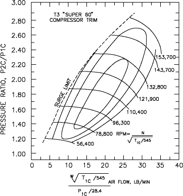

RotrexFiero - The big problem with turbocharger selection is knowing what the flow effeciency of your engine is. You use that to determine the approximate pressure ratio versus flow. From what you have written, I think a Garrett T3 with a Super 60 wheel would be just right. If you are looking for one, I have a friend with one on the shelf. I will see if he is willing to part with it and for what price.
Matt

Report this Post07-21-2003 09:44 PM Click Here to See the Profile for RotrexFieroClick Here to visit RotrexFiero's HomePageSend a Private Message to RotrexFieroDirect Link to This Post
Matt, I would very much appreciate that...it would be a big help since I have the engine out I can position and fabricate a mouting bracket much easier than once it is in the car. I love the support I recieve on this forum.

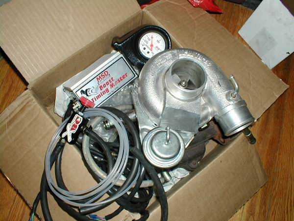

Report this Post07-25-2003 04:34 PM Click Here to See the Profile for Matt HawkinsSend a Private Message to Matt HawkinsDirect Link to This Post
Rotrexfiero - I am having my friend bring the turbo over so I can verify what it is. I know it is brand new, never used. He is asking $350 for it. If it is what he thinks, it is worth the price. I will let you know.

Matt,
Tell him I will call him...send me his telephone number. I would also like a picture if you have it.
