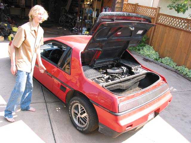

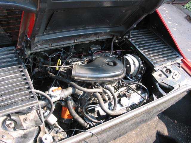

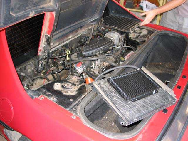

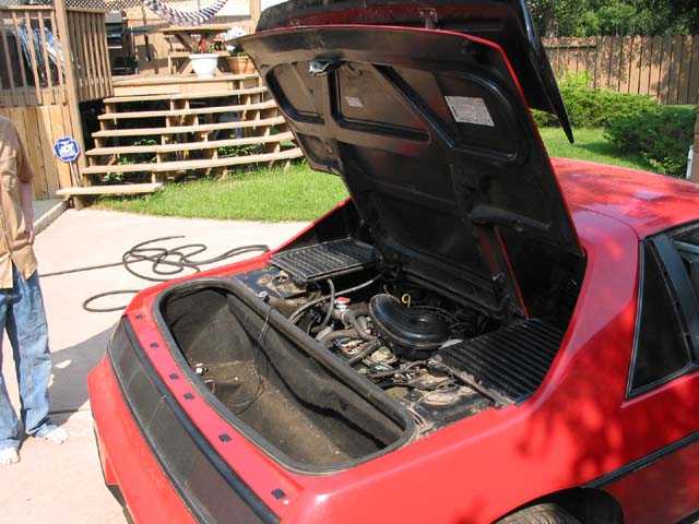

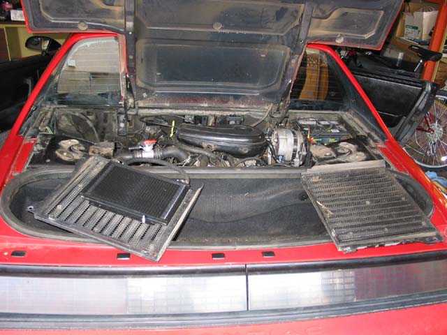

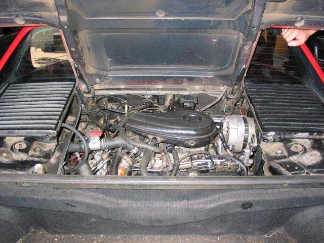

Thanks for filling the forum in Tim! Hey guys, She's Alive!!! Man I'm so happy and excited to finally be seeing the end results of this project. Here are some pictures and a link to where you can download 2 video's.
