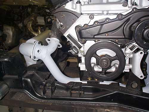

Ok this could be really really good. PBJ are you telling me that the 94 deville crossover pipe will fit nicely in the fiero cradle? If so I will go back to the scrapyard and get it. Is that what this picture is of?
that picture is of the Seville exhaust manifolds on Rockcrawls newest motor with custom piping. Seville exhaust goes under the motor. Deville exhaust manifolds have a connection pipe or crossover pipe that goes over the transmission on the drivers side of the car and the exhaust exits at the middle of the rear manifold.

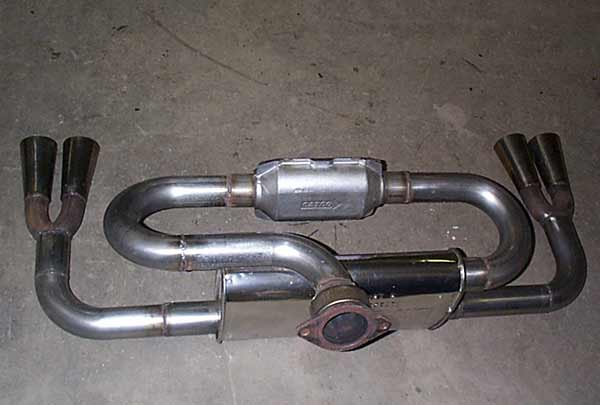

this is Rockcrawls Deville exhaust setup, notice the hook up flange is in the middle of the system and would hook up to the rear manifold. You also need to cut off the trunk bottom to run this system.

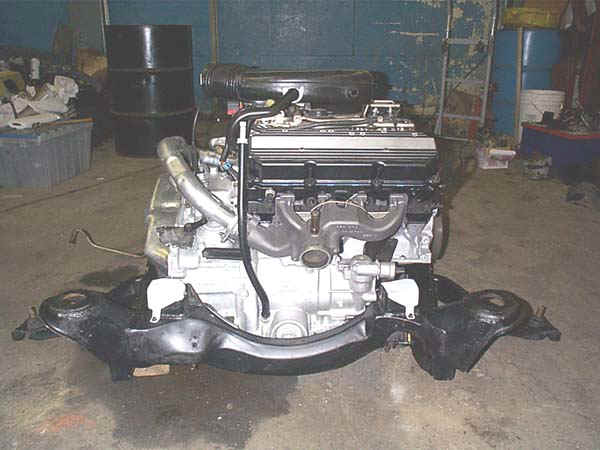

If I remember right Rockcrawl may have used two rear manifolds or two front manifolds.You'd have to find the post where he introduces his new motor. Anyway here are pictures of the Deville manifolds and crossover pipe. I myself an going to use the Deville manifolds with the crossover, cut off the trunk bottom and run something like in this first picture

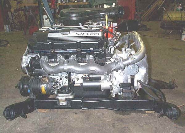

Here is the Deville setup,exhaust above mounts to this setup.
